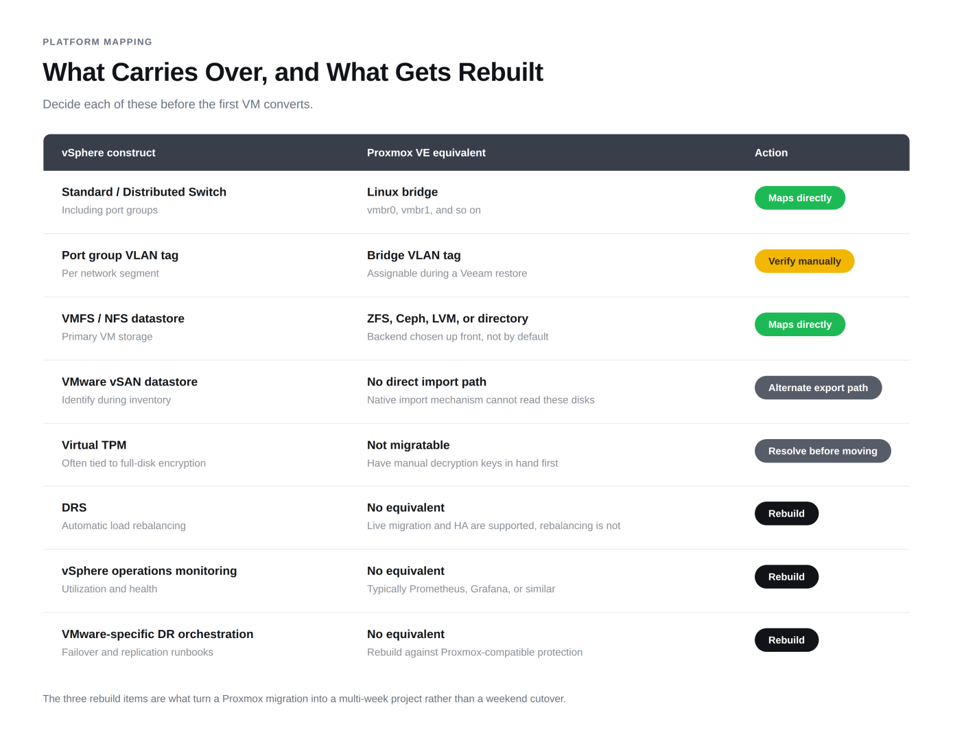

What Doesn’t Carry Over Automatically
Some things have no Proxmox equivalent waiting for them. Knowing which ones those are before you build the project plan is what keeps a migration from stalling halfway through. Three gaps matter most:
  • Automatic VM placement. Proxmox VE supports live migration between cluster nodes and high availability for automatic restart on node failure, but there’s no built-in DRS equivalent. Rebalancing is manual or scripted.
  • Operations monitoring. vSphere-native operations tooling doesn’t extend to Proxmox VE. Most teams stand up Prometheus, Grafana, or a similar stack instead.
  • DR orchestration. Failover and replication processes built against VMware-specific orchestration won’t recognize Proxmox VE as a source or a target, so those runbooks get rebuilt rather than repointed.
None of this is a reason not to migrate. These are line items to scope and budget, and they’re the reason a Proxmox migration is usually a multi-week project rather than a weekend. Our guide to Proxmox high availability covers what the platform does natively give you.

Networking and Storage Mapping
Neither networking nor storage carries over on its own. Both need a decision to be made before the first VM converts, because a VM that lands on Proxmox VE with the wrong bridge or an unplanned storage backend has to be reworked rather than adjusted.
Network mapping. vSphere Standard and Distributed Switches, along with their port groups, all map to Proxmox Linux bridges, including vmbr0, vmbr1, and so on. VLAN tags are the part that trips people up. They need to be validated and replicated exactly and not assumed to travel with the VM. Confirm the tag on the Proxmox side against the source port group before the workload goes live, because a VM on the right bridge with the wrong tag looks healthy but can’t reach anything.
Storage mapping. VMFS, NFS, and VMware vSAN datastores each need an equivalent Proxmox storage backend chosen up front, whether that’s a ZFS pool, a Ceph cluster, LVM, or shared directory storage. This decision drives performance, snapshot behavior, and how much rework you’re signing up for, so make it deliberately rather than accepting whatever the import defaults to.
One hard limitation to plan around is VMs with disks backed by VMware vSAN, which can’t be imported directly through the native import mechanism. Those workloads need an alternate export path, so be sure to identify them during inventory rather than discovering them when the wizard refuses the job.

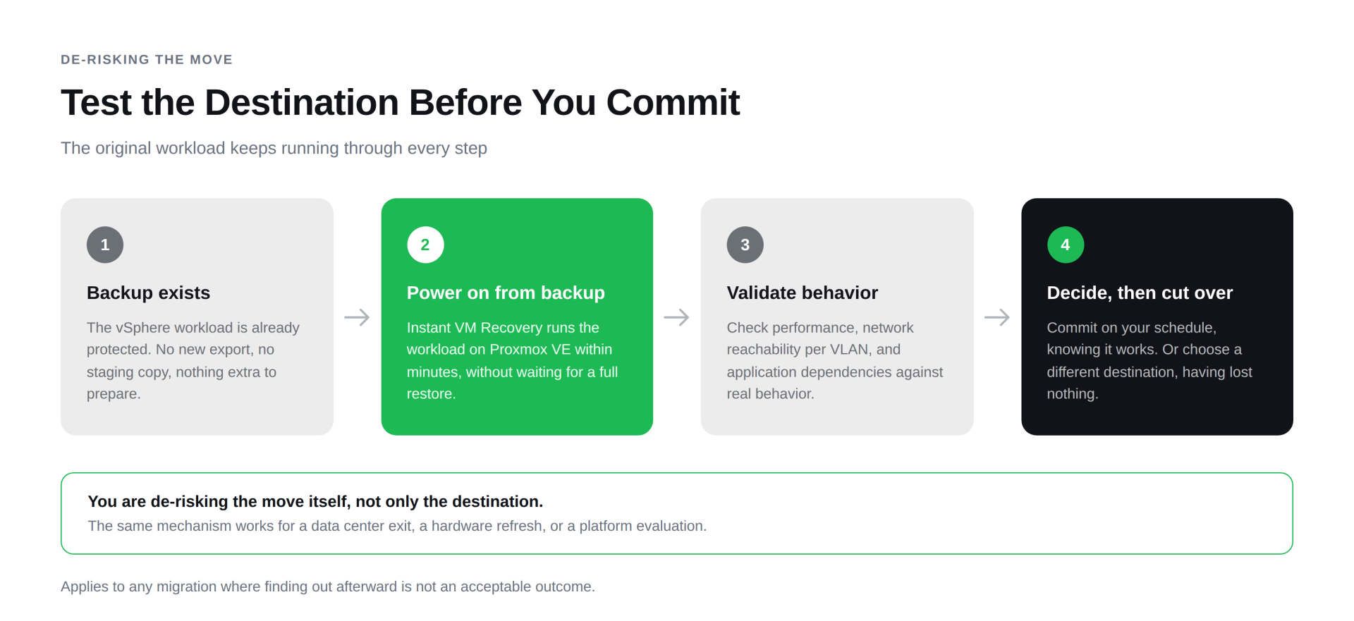

Using Instant Recovery to De-Risk the Migration Itself
Most migration planning asks the wrong question at the wrong time. Planning is often focused on the destination, asking if Proxmox VE is the right platform, will workloads perform, and  what breaks? These are things that should be answered before you commit, not after.
Instant VM Recovery powers a workload directly from its backup, in minutes, without waiting for a full restore to complete. Point that at your new platform and the migration stops being a leap. You spin the workload up on Proxmox VE from a backup you already have, confirm it behaves the way you expect, and only then plan the real cutover. In Veeam Data Platform, this extends to running Proxmox VE VMs from backups taken on other supported platforms and then migrating them to production storage, available under experimental support in the current release.
vSphere constructs mapped to their Proxmox VE equivalents, with the items requiring a rebuild listed below.
That changes the decision, not just the execution. You’re de-risking the move itself, not only the destination. This way, by the time you commit, you already know it works. This shows up three ways in practice:
  • Choosing a destination. Spin the same workload up on each candidate and compare real behavior, not spec sheets.
  • Accelerating a data center exit or hardware refresh. The project stops waiting on a slow, high-risk cutover.
  • Reducing risk on any migration. You find out what breaks while the original is still running.
In every one of these cases it comes back to the same mechanism: Critical VMs powered on directly from backup within minutes, so the business keeps running while the migration happens around it.

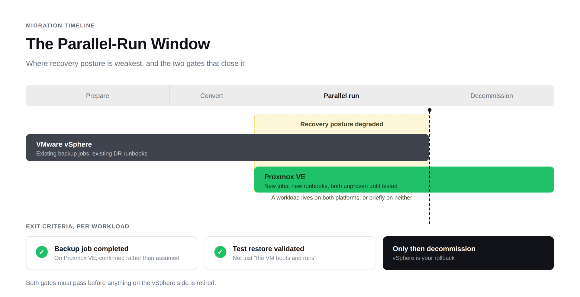

Here’s what migration guides tend to leave out. For a stretch of time, every workload you’re moving exists on vSphere and Proxmox VE at once, or briefly on neither. That stretch is a period of degraded recovery posture, and it doesn’t manage itself.
A failure here is quiet. A VM cuts over to Proxmox VE, the old backup job keeps pointing at a source that no longer holds the live workload, and the job may even keep reporting success. Nobody finds out until someone needs a restore and then it’s discovered that the most recent usable copy predates the migration. Backup coverage needs to be deliberately carried across that boundary, workload by workload, rather than reconnected once the project is done.
Three things need attention while the parallel run is open:
  • Job configuration. Every migrated workload needs its backup job updated or recreated against the new platform, and the first run on the new side needs to be confirmed rather than assumed.
  • Recovery Point Objectives and Recovery Time Objectives (RPOs and RTOs). Re-validate both against what backup and restores actually do on Proxmox VE. Carrying forward numbers documented for your vSphere process gives you a commitment you haven’t tested.
  • DR runbooks. Any failover or replication process built against VMware-specific orchestration needs rebuilding against Proxmox-compatible protection. This is rebuild work, not reconfiguration, and it’s the item that’s most often discovered late.
Four-step sequence for testing a workload on Proxmox VE from its backup before committing to cutover.
Set explicit exit criteria before anything on the vSphere side gets decommissioned and make them evidence-based rather than simply a calendar date. A completed backup job on the new platform, plus a validated test restore, is a real exit criteria. “The VM boots and runs” is not. Write those two conditions into the migration plan for every workload, and the parallel-run window will close when the evidence says so, not when the schedule does.
The reason this matters is because the vSphere environment is your rollback. Decommission it before the new platform’s protection is tested and proven, and you’ve removed your own safety net at exactly the moment you’re most likely to need it.
