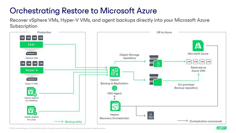

Next, restore Hyper-V backups to Azure, and can I say I have been waiting for this feature since we first announced Hyper-V support? Cloud Plans already supported restoring vSphere VM and Veeam Agent backups to Azure. Meanwhile, Hyper-V shops have been stuck watching from the sidelines ever since, having to rely on a secondary physical site for DR while everyone else got to use the cloud as a recovery target with no hardware to manage. Now Hyper-V VM backups can join them, with script injection to restored VMs supported as well. If Hyper-V is part of your environment, your cloud DR options just got a lot less limited.

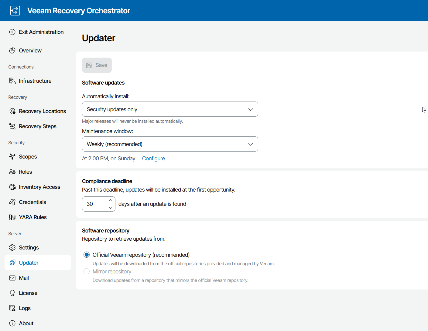

Orchestrator v13.1 introduces the Veeam Updater plug-in, launchable right from the About page in the Orchestrator web UI. It flags critical patches and updates, and it brings three capabilities worth knowing about:
  • Update scheduling and automation, so you can define maintenance windows and control when updates install.
  • Mandatory updates, so you can enforce required patch levels across all managed Veeam Backup & Replication components.
  • Bulk update management, so you can update multiple infrastructure components at once and streamline maintenance.
If keeping a distributed Veeam environment patched has ever felt like a part-time job, this is aimed squarely at you.
