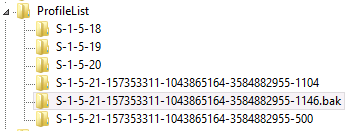

  • レジストリのProfileListに.bakキーがないことを確認します。Verify that there are no .bak keys in the ProfileList within the Registry.
    HKLM\Software\Microsoft\Windows NT\CurrentVersion\ProfileList
example of .bak profile in list
Example of .bak profile
