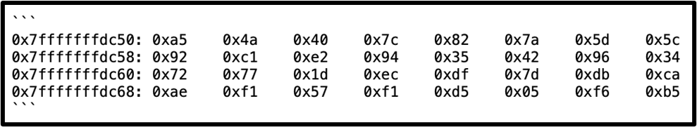

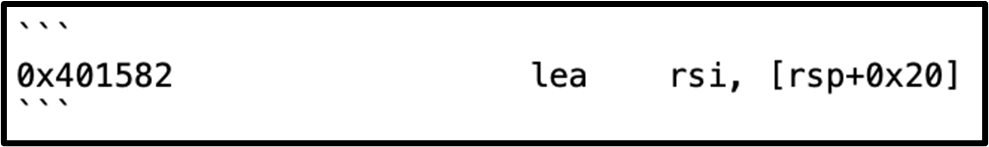

Within the Nitrogen ESXi malware, the public key is stored as a stack variable at offset rsp+0x20 (shown below).

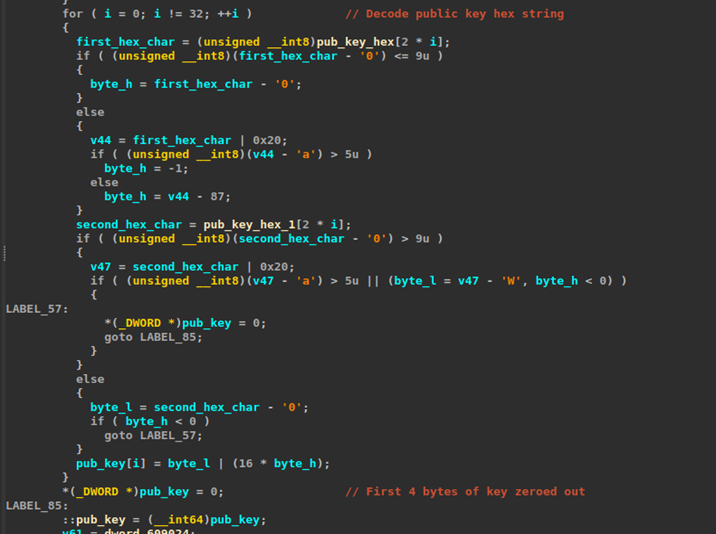

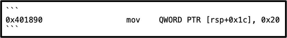

However, after the public key is loaded, another variable is stored at rsp+0x1c. It’s a QWORD, so it takes up the 8 bytes from rsp+0x1c to rsp+0x24. That means 4 bytes of the public key are overwritten. This appears to be a clear mistake by the malware developer.
This is what the public key looks like in memory before the instruction at `0x401890` is executed

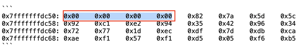

And this is what it looks like after it’s executed:
Note the 4 bytes that have been replaced with 0x00s.
Because of this bug, the corrupted public key is used in the key exchange to encrypt each file. Normally, when a public/private Curve25519 keypair is generated, the private key is generated first, and the public key is derived from it. Here, the corrupted public key was not derived from any private key. It’s a malformed key produced by accidentally overwriting part of an otherwise valid public key. The outcome is that no one actually has the private key corresponding to the corrupted public key, so files encrypted using it can’t be decrypted by any means, including by paying a ransom. The threat actor themselves will be unable to decrypt affected files, even in a controlled test.
