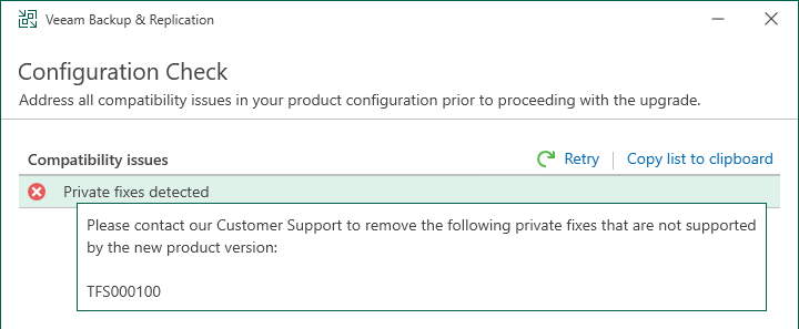

The error above occurs when attempting to upgrade using an ISO from version 12.0, 12.1.0, or 12.1.1.
If Veeam Backup & Replication 11a P20240304 is installed, the upgrade must be performed with an ISO for version 12.1.2 or later.
The private fix indicated in this error cannot be removed.

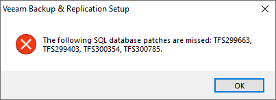

The following SQL database patches are missed: TFS299663, TFS299403, TFS300354, TFS300785
Cause
The TFS values in the error are related to cumulative updates that have been installed and recorded within the Veeam Backup & Replication configuration database.
The ISO for Cumulative Update releases, indicated by a P in the build number, contain the initial version's installer and the cumulative update patcher. When this ISO is used to install, it first deploys the initial GA build of that version of Veeam Backup & Replication, and then as a post-install action, runs the cumulative update patcher. For example, running the installer for the 11.0.0.837 P20210525 ISO would first install 11.0.0.837, then run the cumulative update patch P20210525.
The cumulative updates may include changes to the configuration database that the base version installer is not compatible with and causes the base version installer to fail when run.

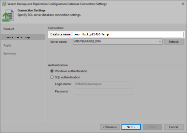

Part 1: Switch Veeam Backup & Replication to Temporary Database
- Open the Veeam.Backup.DBConfig tool.
- Select the Veeam Backup & Replication product and click Next.
(If Backup Enterprise Manager is not installed, this option will not appear.)

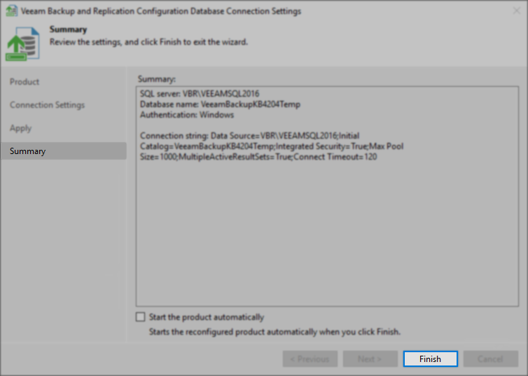

- On the Connection Settings page, change the Database Name entry to specify the temporary database (e.g., VeeamBackupKB4204Temp)
Take note of which database was in use, as you will need to enter that in Part 3 of this workaround.
- Click Next and answer the prompts as the DBConfig tool stops product services, modifies the database settings, and starts the product services.
- On the Summary step of the wizard, only Click Finish. (Do not select the option to "Start the product automatically")

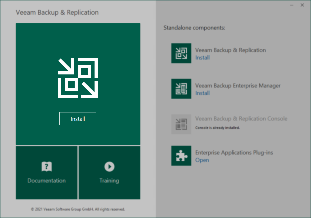

- Mount the Veeam Backup & Replication ISO
- Select the option to Install Veeam Backup & Replication

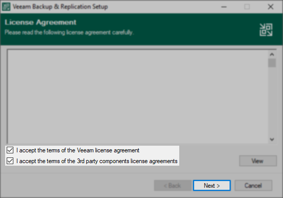

- Confirm the License Agreements, click Next

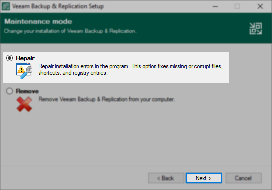

- On the Maintenance mode tab of the wizard, select Repair, Click Next
- On the following pages, confirm credentials, and finally, click Install to begin the repair.
