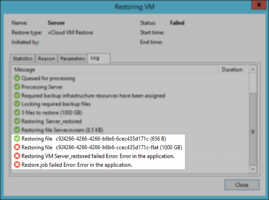

When performing a vCloud VM Restore, the operation fails with the following generic error message:
Restore job failed Error: Error in the application.
Example of error
Take note of how the -flat file that failed to restore is missing its .vmdk file extension.
