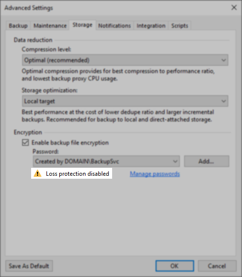

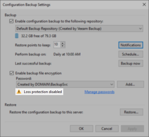

When configuring backup file encryption, the following warning is shown:
Loss protection disabled
Cause
This warning appears when the Veeam Backup & Replication installation is not managed by a Veeam Backup Enterprise Manager server, which in turn enables Password Recovery.
If you lose or forget your password, you will not be able to recover data from backups or tapes encrypted with the password, unless you use Enterprise Manager keys in the encryption process.

Enabling Password Loss Protection
To enable password loss protection, add the Veeam Backup & Replication server to a Veeam Backup Enterprise Manager server.
If no Veeam Backup Enterprise Manager server is present in the environment, one must be deployed.
