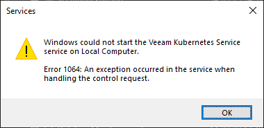

When the short date locale setting is configured to display the year as two digits (YY), the Veeam Kubernetes Service service fails to start automatically. When attempting to start the service manually, a pop-up appears with the error:
Windows could not start the Veeam Kubernetes Service service on Local Computer. Error 1064: An exception occurred in the service when handling the control request.
