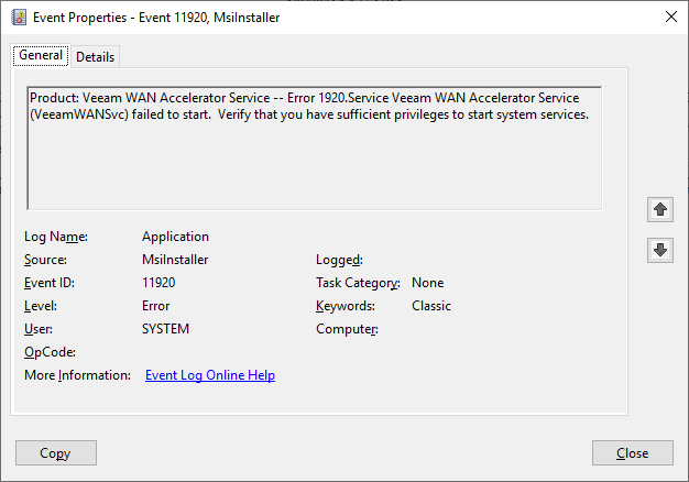

The Veeam WAN Accelerator component upgrade fails with the following error:
Failed to upgrade host components. Error: ''Error 1920.Service Veeam WAN Accelerator Service (VeeamWANSvc) failed to start. Verify that you have sufficient privileges to start system services.'
The Components Update wizard appears during the first launch of Veeam Backup & Replication Console after an upgrade.
Cause
The Veeam WAN Accelerator component upgrade failed to complete because the associated service could not start.
On the component server, in the C:\ProgramData\Veeam\Backup\Svc.VeeamWANSvc.log file, the following details indicate the issue related to a drive that is no longer present.
srv | RootFolder = D:\VeeamWAN srv | SendFilesPath = D:\VeeamWAN\Send srv | RecvFilesPath = D:\VeeamWAN\Recv srv | ERR |Fatal error srv | >> |boost::filesystem::create_directories: The system cannot find the path specified: "D:\" srv | >> |Unable to apply settings. See log for details. srv | >> |An exception was thrown from thread [ ]. srv | Stopping service...
