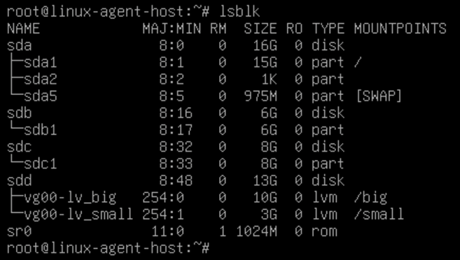

After performing the restore, the restored VM's disk layout should be reviewed. In addition to the original disks, a new disk is present for each of the VGs (Volume Groups), equal in size to the combination of all LVs (Logical Volumes) in each VG from the original Linux machine.
Example Restored VM Configuration
  • Disk sda is restored as is.
  • Disks sdb and sdc are restored, and their partitions (sdb1 and sdc1) are present.
  • Disk sdd is new, and is sized to match the combined size of all LVs within the VG.
    • The logical volumes lv_big and lv_small are mounted as expected.

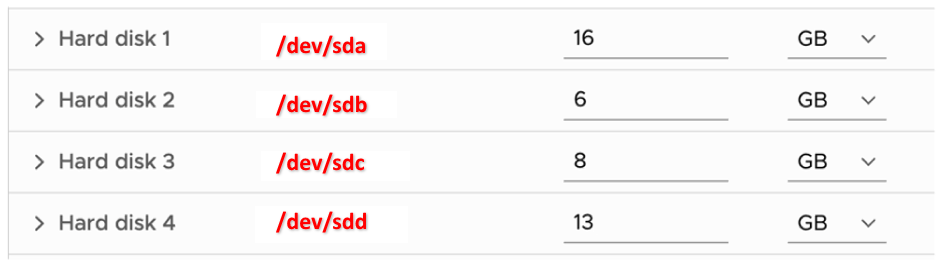

For this example, the machine was restored to VMware vSphere, and we can see in the VM's settings the disks:
vSphere VM Disks
Note: If there are multiple disks with the same size, use the command lsscsi to identify the SCSI nodes assigned to each disk and then correlate those to the VM configuration.
Example:
# lsscsi
[0:0:0:0]    disk    VMware   Virtual disk     2.0   /dev/sda
[0:0:1:0]    disk    VMware   Virtual disk     2.0   /dev/sdb
[0:0:2:0]    disk    VMware   Virtual disk     2.0   /dev/sdc
[0:0:3:0]    disk    VMware   Virtual disk     2.0   /dev/sdd
Based on this, we can see that /dev/sdd is SCSI node 0:3, which correlates to the following VM disk:
SCSI node correlation

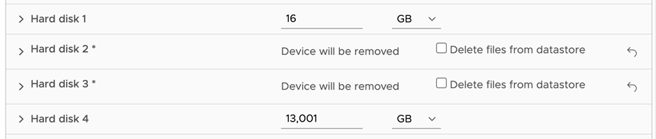

After identifying which VM disks represent the unused disks, in the ongoing example, sdb and sdc, perform the following to detach them from the VM:
  1. Power off the restored VM.
  2. Edit the VM in the vSphere Client.
  3. Remove disks, but don't delete the disks.
detach disks

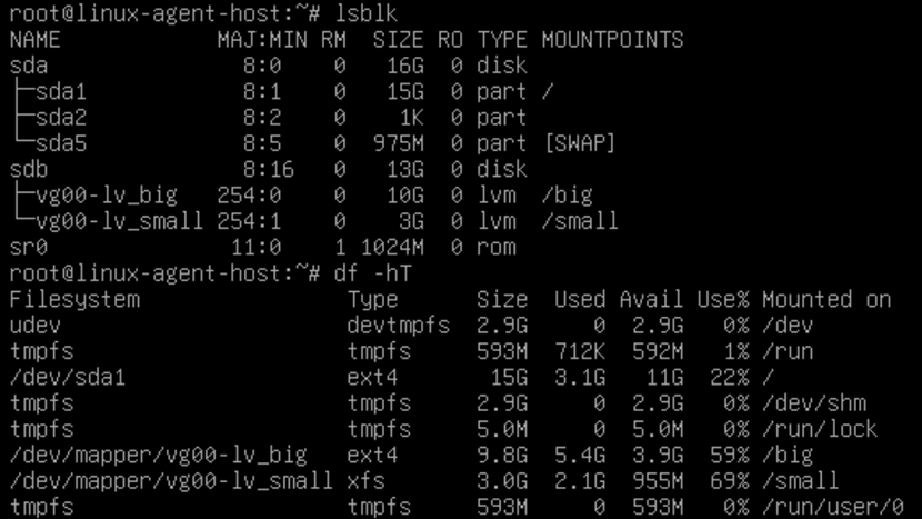

  1. Save the new settings of the VM and start it.
  2. Review the disk configuration and ensure that the filesystems are mounted properly using:
lsblk
df -hT
Example
Note that sdd is now listed as sdb.
post disk removal configuration example
