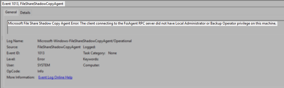

When either type of job fails the following error will be found in the Windows Event Logs of the File Server hosting the SMB3.0 shares:
Microsoft File Share Shadow Copy Agent Error: The client connecting to the FssAgent RPC server did not have Local Administrator or Backup Operator privilege on this machine.
