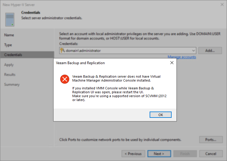

When attempting to add Microsoft Hyper-V Servers to Veeam Backup & Replication the following error is displayed:
Veeam Backup & Replication server does not have Virtual Machine Manager Administrator Console installed.
If you installed VMM Console while Veeam Backup & Replication UI was open, please restart the UI.
Make sure you're using a supported version of SCVMM (2012 or later).
Add HV Host Error

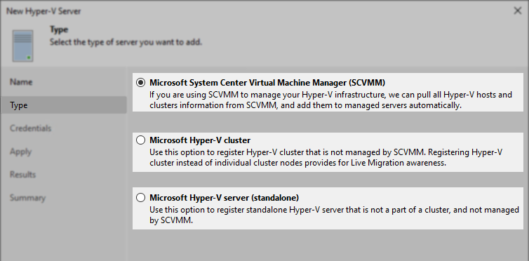

  • The wrong server type was selected on the 'Type' tab.

    If there is no System Center Virtual Machine Manager (SCVMM) server in the environment
    • Return to the Type tab of the New Hyper-V Server wizard and select either Hyper-V Cluster or Hyper-V Standalone.
    Server Types
    More Information
    • When adding a Hyper-V server, the server type Microsoft System Center Virtual Machine Manager is selected by default on the Type tab. The correct server type must be chosen.
