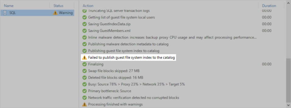

A backup job's task is completed with the warning:
Failed to publish guest file system index to the catalog

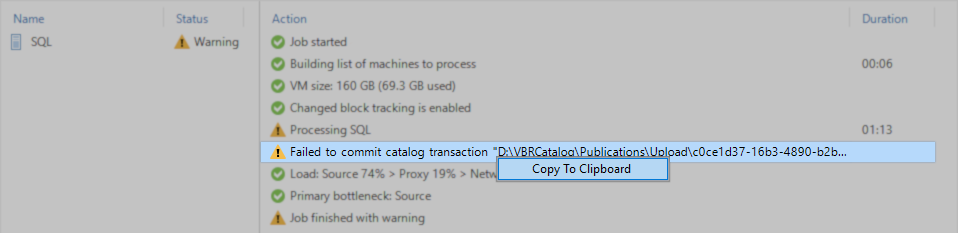

An additional message will appear in the Statistics window at the job summary level. Right-click on that warning, select Copy to Clipboard, and then paste it into a text document to view the entire warning message.
