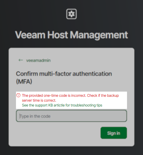

When attempting to connect to the Veeam Host Management Console, after entering the MFA TOTP code, the following error occurs:
The provided one-time code is incorrect. Check if the backup server time is correct.
Screenshot showing a failed attempt to sign in using an MFA TOTP code. The error discussed is highlighted.

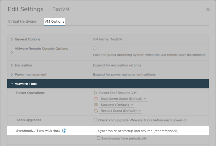

This may look different in different hypervisors. For example, in VMware, this option is available in the VM Options:
Screenshot of VM's VM Options table with the VMware Tools section expanded and the option for Synchronize at started and resume disabled.

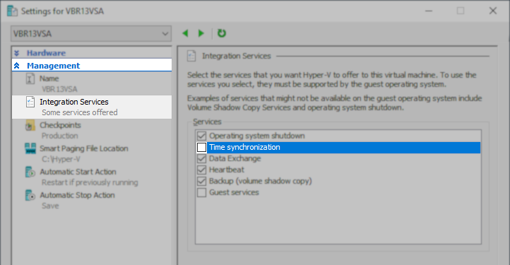

This is an example of the Time syncronization option in Hyper-V:
Screenshot of a Hyper-V VM's settings with the Integration Services section selected and the option for "Time syncronization" disabled.

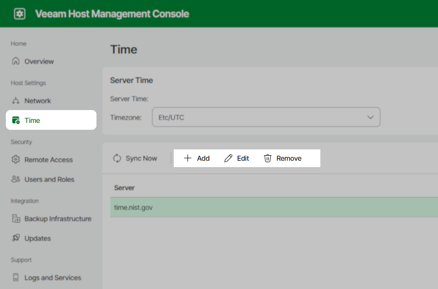

Update NTP via Veeam Host Management Console WebUI
If access to the Veeam Host Management Console is possible (e.g., the issue is intermittent or another Host Admin has MFA disabled for their account), the NTP servers can be configured using the web UI.
Screenshot of the Veeam Host Management Console with the Time section selected and the options for Add, Edit, and Remove are highlighted to indicate how NTP servers can be modified

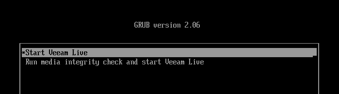

  3. Boot from the Veeam Live OS ISO.
Screenshot of Veeam Live grub boot menu showing "Start Veeam Live" highlighted.

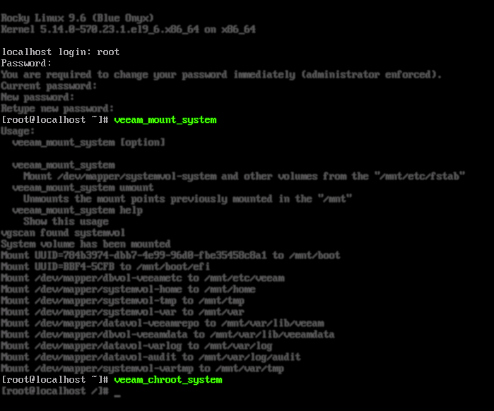

  1. Log in with the root / veeam credentials.
  2. Run the following command to mount the VSA system:
veeam_mount_system
  1. Run the following command to enter the chroot of the main system:
veeam_chroot_system
screenshot of terminal showing the previous commands being executed

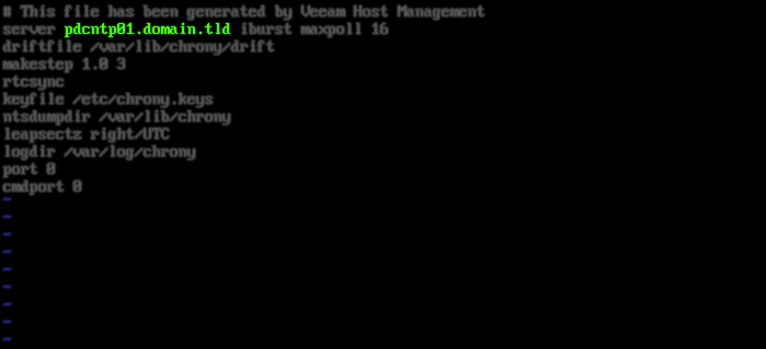

  1. Using vi, edit the /etc/chrony.conf file and specify the correct NTP server for synchronization.
vi /etc/chrony.conf
screenshot of a modified version of the /etc/chronyd.conf file with the NTP server set as pdcntp01.domain.tld
Example /etc/chronyd.conf
