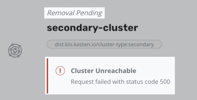

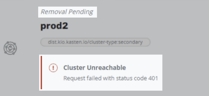

The Veeam Kasten for Kubernetes multi-cluster dashboard displays ‘Removal Pending’ for primary and secondary clusters, as shown below:
401
500
