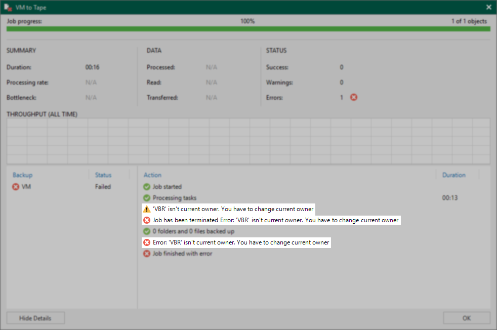

'<VeeamServerName>' isn't current owner. You have to change current owner
Job has been terminated Error: '<VeeamServerName>' isn't current owner. You have to change current owner
Screenshot of tap job failing with above error.

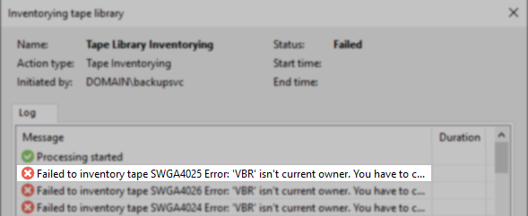

Failed to inventory tape <TapeName> Error: '<VeeamServerName>' isn't current owner. You have to change current owner
Screenshot of Inventory task failing with above error

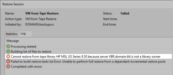

Cannot restore from tape library <LibraryName> because server <VeeamServerName> is not a library owner
Screenshot of restore job failing with above error

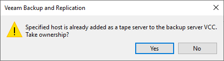

  1. Edit the Tape Server entry
  2. When the "Edit Tape Server" wizard opens, click Next
    A pop-up should appear stating:
    "Specified host is already added as a tape server to the backup server xyz. Take ownership?"
  3. Click  [ Yes ]
Screenshot of Take ownership prompt
  1. In the "Edit Tape Server" wizard, click [ Finish ] to close the wizard and reclaim the Tape Server.

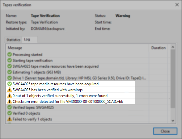

When the Tape Server has been claimed by another Veeam Backup Server, attempting to run Tape Verification on the original Veeam Backup Server where that Tape Server was connected will display an unclear warning. This warning does not make clear that the failure to verify is because the Veeam Backup Server cannot communicate with the Tape Server.
Screenshot of Verification warning.
