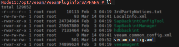

  1. Edit the veeam_config.xml file located in:
/opt/veeam/VeeamPluginforSAPHANA
vi /opt/veeam/VeeamPluginforSAPHANA/veeam_config.xml
veeam_config location

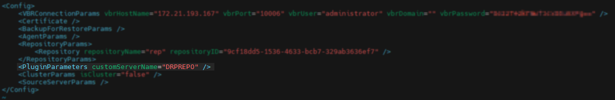

  1. Within the “PluginParameters” node, append a unique name for the “customServerName” value.
    In this example, “DRPREPO” was used.
  1. Update the veeam_config.xml on each of the related nodes in the system replication setup so that each group of replication nodes has its own shared but unique customServerName value.
If a new node is added, the veeam_config.xml on that node must be modified to match.
