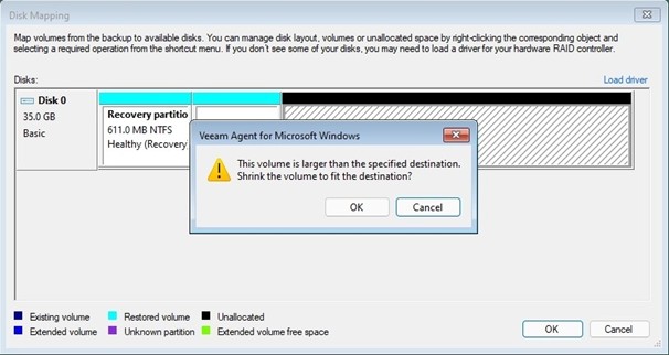

NOTE:
The amount of data on the source volume inside the backup file must be less than the available disk space on the destination hard disk, or it won’t be possible to shrink the disk.
If the target machine has less disk space, you can use the Veeam Recovery media to shrink the source volumes. This allows you to recover your backup to a smaller disk than the source disk size.
