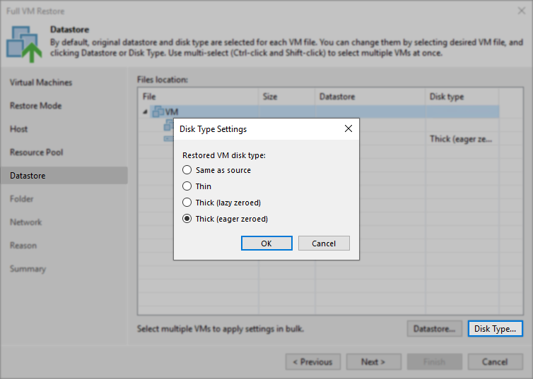

Entire VM Restore
On the Datastore tab of the Entire VM Restore wizard, use the Disk Type button in the bottom-right corner to set the restored disk type to "Thick (eager zeroed)."
Entire VM Restore wizard with Thick (eager zeroed) disk type selected

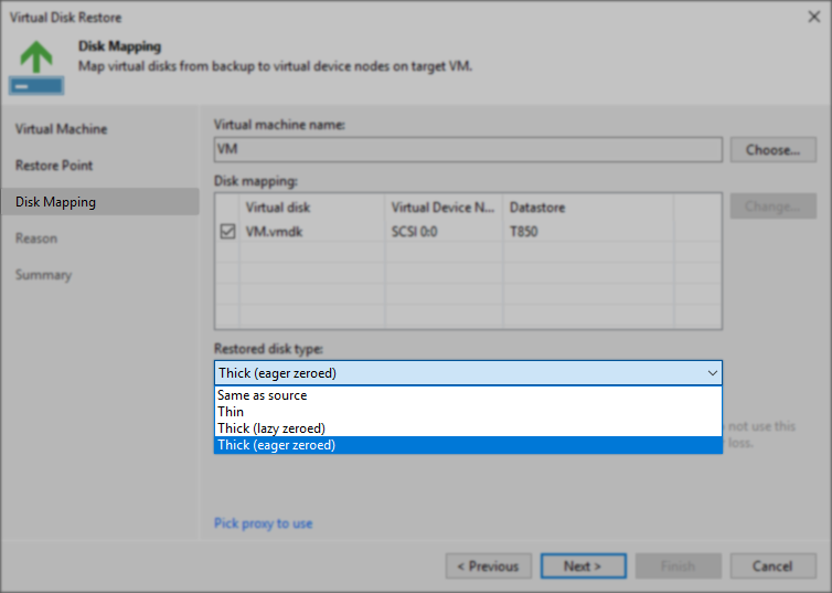

Virtual Disk Restore
On the Disk Mapping tab of the Virtual Disk Restore wizard, use the Restored disk type dropdown box to select "Thick (eager zeroed)."
Virtual Disk Restore wizard with Thick (eager zeroed) disk type selected
