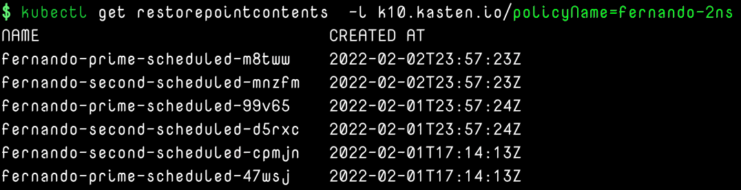

- Check all restorepointcontents for the policy using the following command:
Replace <PolicyName> with the actual policy name.

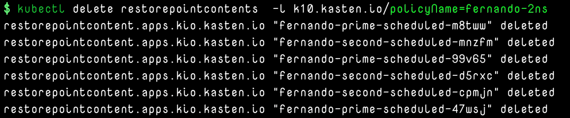

- Delete the restorepointcontents associated with that policy, using the following command:

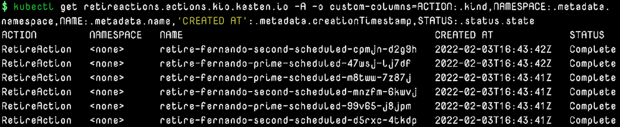

- Track and ensure the retireactions complete with the following command:

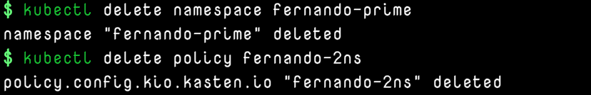

- After all retireactions are complete, use the following command to remove the Namespace and the Policy:
