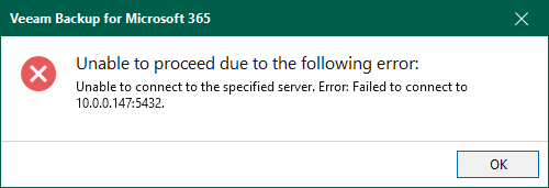

When attempting to install Veeam Backup for Microsoft 365 on a machine where Veeam Backup & Replication is already installed, and that deployment of Veeam Backup & Replication is using the included local PostgreSQL Instance, the Veeam Backup for Microsoft 365 installer fails with the error:
Unable to proceed due to the following error: Unable to connect to the specified server. Error: Failed to connect to: <IP>:<port>. For more details, see KB4638: https://www.veeam.com/kb4638.
