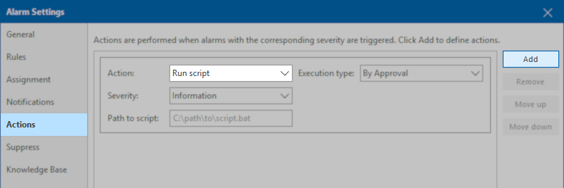

- As an alarm notification action — select this option if you want to run a custom script when the alarm is triggered or when the alarm status changes. By running a script, you can automate routine tasks that you normally perform when specific alarms fire. For example, if a critical system is affected, you may need to immediately open a ticket with in-house support or perform corrective actions that will eliminate the problem.
- As an alarm remediation action — using this option, you can specify what actions must be performed after the alarm is triggered or after the alarm status changes.

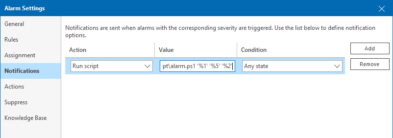

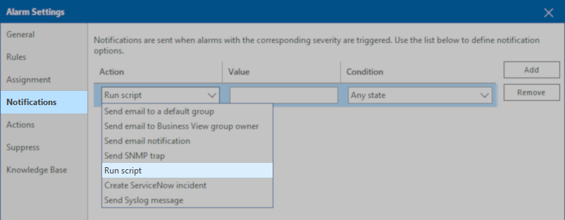

Notification Action Configuration
Edit the Alarm, and add a 'Run script' action, and for the value specify the script and include the variables that will be passed to that script. For this example, the action value is:
powershell.exe C:\scripts\alarm.ps1 '%1' '%5' '%2'
