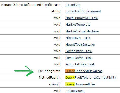

  1. On the VM's MOB page click the link for QueryChangedDiskAreas.

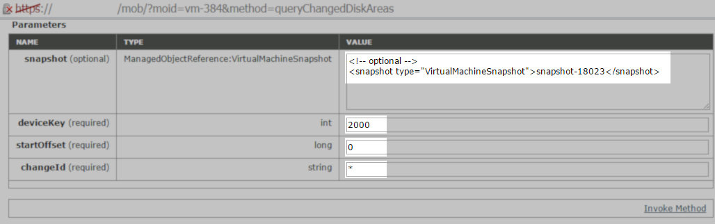

  1. Insert the following parameters:
    • snapshot reference id
    • device key of a virtual disk (typically, the VM's first disk is #2000)
    • start offset (the beginning of the required changed area)
    • change id — use an asterisk [ * ] to query all used space.
invoke

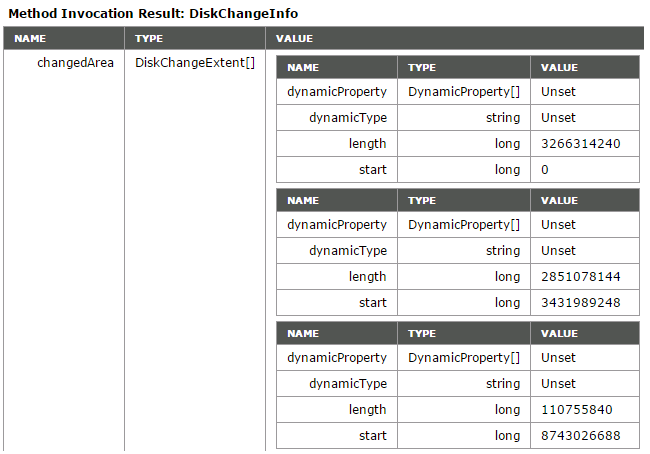

  1. Click Invoke Method and the results will be shown at the bottom in the same window.
  2. The table contains changed disk areas start offsets and lengths.
