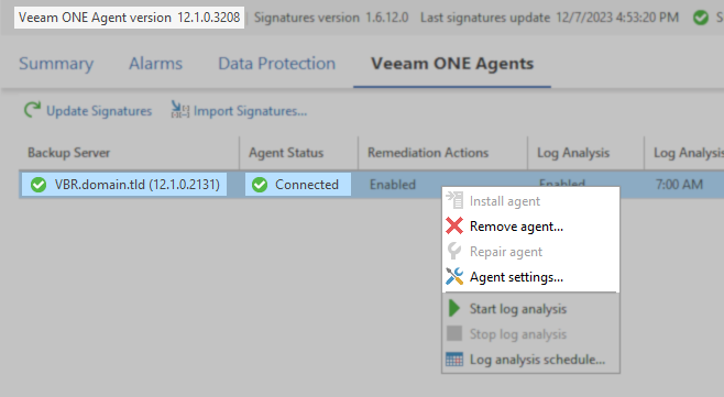

Scenario 1: Veeam ONE Agent is Already Installed
Veeam ONE Agent version: Correct version shown
Backup Server: Green Checkmark
Agent Status: Connected (Green Checkmark)
Available Options: [Remove Agents...] and [Agent settings...]
In this scenario, the Veeam ONE Agent is already deployed and cannot be installed on this Backup Server again.
Solution
This state is the expected successful state.
Normal

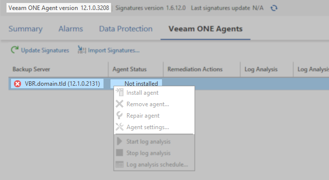

Scenario 2: Veeam Backup Server Cannot Be Reached
Backup Server: Red X
Agent Status: Not installed
Available Options: None
In this scenario, the Veeam ONE Agent cannot be installed because the Veeam ONE server cannot reach the Veeam Backup Server.
Solution
To resolve this, ensure network connectivity between the Veeam ONE server and the Veeam Backup Server, and that the Veeam ONE server has the correct credentials to communicate with the Backup Server. If a Firewall is involved, review the required ports for Veeam ONE.
No Connection

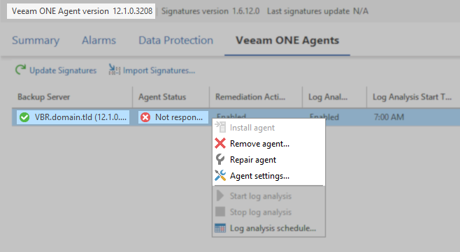

Scenario 3: Veeam ONE Agent Port is Blocked
Agent Status: Not responding (Red X)
Available Options: [Remove Agents...], [Repair agent], and [Agent settings...]
In this scenario, the Veeam ONE Agent was deployed successfully and cannot be deployed on this Backup Server again. However, the "Not responding" status for the Agent indicates that the Veeam ONE Server cannot communicate with the Veeam ONE Agent deployed on the Backup Server.
Solution
If the "Repair agent" function does not resolve the issue, review the connection between the Veeam ONE Server and the Backup Server and ensure connectivity over port 2805.
VONE Agent Port Blocked

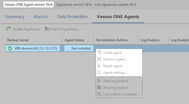

Scenario 4: Veeam ONE Agent on the Veeam ONE Server is Misconfigured
Veeam ONE Agent version: displayed as "N/A"
In this scenario the Veeam ONE Monitor service is unable to communicate with the Veeam ONE Agent service. At this time, there are two known possible causes of this issue:
  • The PrimaryOneAgentId value in the registry does not match the Veeam ONE Agent Service ID.
    or
  • The Veeam ONE Agent service running on the Veeam ONE server is operating in Worker mode instead of Master mode.
    Note:
    This may occur more often in deployment scenarios where Veeam ONE and Veeam Backup & Replication have been installed on the same machine, which is supported but not recommended.
Solution
Review the steps after the screenshot for information about resolving this scenario.
VONE Agent Wrong Mode

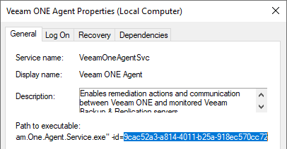

Check Veeam ONE Agent Service Operating Mode
  1. Connect to the Veeam ONE Server
  2. Restart the Veeam ONE Agent service (Services.msc).
    This step ensures that the log file will have a recent entry declaring operating mode.
  3. Open the folder: C:\ProgramData\Veeam\OneAgent\Log\
  4. Within that folder will be one or more GUID-named folders. Open the folder that was most recently created.
  5. Within that folder, open the file named OneAgent.log.
  6. Search for the string:
    AgentManager.Start actual agent settings:
    Example:
    OneAgent.AgentManager: AgentManager.Start actual agent settings:Id=<guid> AgentType=Master Port=2805
    1. If the AgentType value lists Master, skip to the Check for Agent ID Mismatch section below.
    2. If the AgentType value lists Worker, continue to the next section and Reinstall the Veeam ONE Agent in Master mode.

  1. Connect to the Veeam ONE Server.
  2. Get the Veeam ONE Agent service's ID value.
    1. Open the Service control panel (Services.msc).
    2. Locate the Veeam ONE Agent service.
    3. Right-click the Veeam ONE Agent service and select Properties.
    4. On the General tab, take note of the -id= listed at the end of the Path to executable: value.
      Click and drag as if to highlight the text, and the text will scroll to the right, allowing you to see the -id= value.
service id select

Relaunch and Reattempt Install Agent
  1. Close the Veeam ONE Client.
  2. Restart the Veeam ONE Monitoring Service service.
  3. Launch the Veeam ONE Client.
  4. Navigate to the Veeam Backup & Replication > Veeam ONE Agents tab.
  5. Confirm that the Veeam ONE Agent version:, which was previously displaying N/A, now displays a version number.
    Note: If the version it is still listed as N/A, please create a Veeam Support case for assistance.
  6. Wait 5 minutes to allow the Veeam ONE services to refresh connection data for the Veeam Backup & Replication server.
  7. Reattempt to Install the Veeam ONE Agent on the Veeam Backup & Replication Server.
