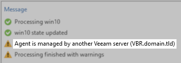

During the Rescan of a Protection Group, a machine displays the warning:
Agent is managed by another Veeam server (<other_Veeam_server>)
Warning
