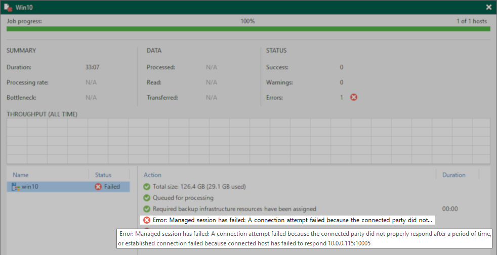

A Windows Agent Backup or Windows Agent Policy type job within Veeam Backup & Replication fails with either of the following errors.
  • A Veeam Agent Backup operating in Managed by backup server fails with the error:
    Error: Managed session has failed: A connection attempt failed because the connected party did not properly respond after a period of time, or established connection failed because connected host has failed to respond <vbr_ip>:10005

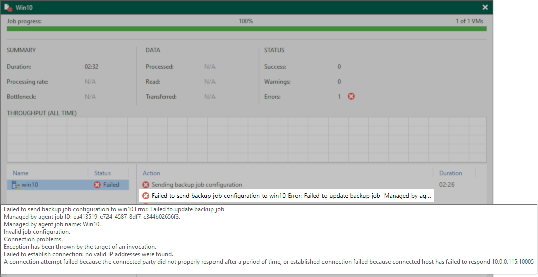

  • A Veeam Agent Policy fails to deploy with the following error:
    Failed to send backup job configuration to <machine> Error: Failed to update backup job
    Managed by agent job ID: <job_id_guid>.
    Managed by agent job name: <job_name>.
    Invalid job configuration.
    Connection problems.
    Exception has been thrown by the target of an invocation.
    Failed to establish connection: no valid IP addresses were found.

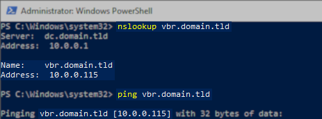

  • Ensure that the Windows machine being backed up can correctly resolve the the hostname and FQDN of the Veeam Backup Server.
nslookup <vbr_fqdn>
ping <vbr_fqdn>
nslookup and ping
Note: The success of ping is not necessary for the functionality of agent management. The ping is only intended to confirm that the machine's local DNS uses the data received from the DNS server, as shown in the nslookup results.

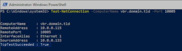

  • Ensure that the Windows machine being backed up can reach port 10005 on the Veeam Backup Server.
Test-NetConnection -ComputerName <vbr.server.ip> -Port 10005
