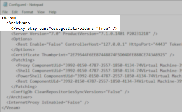

Option 2: Manually Update Config.xml
- Update the Config.xml file to skip the TeamsMessagesData folder.
Only the config.xml file on the main Veeam Backup for Microsoft 365 server needs to be updated.
- Open the folder: C:\ProgramData\Veeam\Backup365\
The ProgramData folder is hidden by default. Copy and paste the folder path into the Explorer address bar. - Within that folder, create a copy of Config.xml with the extension .old (i.e., Config.xml.old).
If the Config.xml file is not present, double-check the folder path (i.e., ProgramData not Program Files). - Launch NotePad as an Administrator, and open C:\ProgramData\Veeam\Backup365\Config.xml
- Add the following line withinAnywhere below and above . the <Archiver> section and save the file.
<Proxy SkipTeamsMessagesDataFolders="True" />
- Restart the Veeam Backup for Microsoft 365 Service service.
