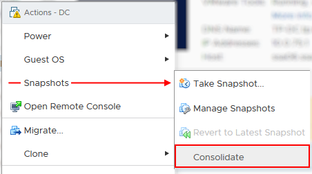

  1. Using a vSphere Client, find any VMs displaying a warning that consolidation is needed.
Warning
  1. Perform consolidation and note which VMs continue to have a warning regarding consolidation.
attempt consolidation
start consolidation

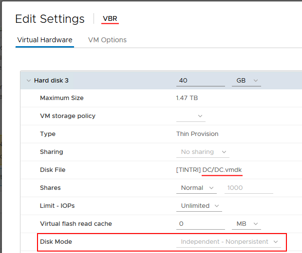

Review the settings of each Veeam VMware Backup Proxy, looking for any disks that match the following:
  • The name of the VMDK does not match the proxy's name, but it matches a VM identified in the previous section.
  • The disk has a Disk Mode of [Independent - NonPersistent]
    Note: If the proxy is used as a Target Proxy for replication, the replica disks will be attached as Independent - Persistent.
Identify Stuck Hotadded Disks

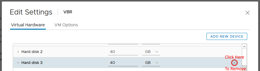

Once you have found a disk HOTADDed to a proxy that needs to be released, perform the following steps to release it.
  1. Click the ⦻ symbol to select the disk for removal.

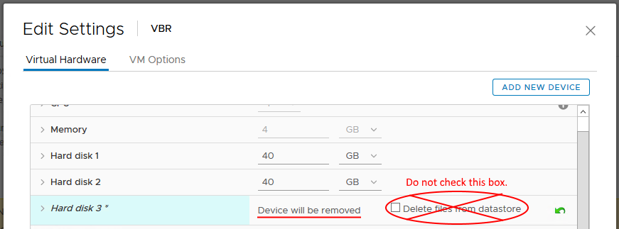

    Note: Do not check the box to delete files from datastore!
release
do not click delete
  1. Click [OK] to Confirm the removal.

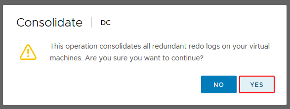

  2. After the disk is released from the proxy, attempt Consolidation again.
Consolidate
