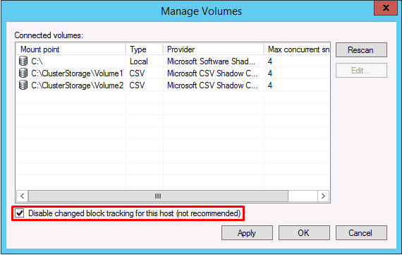

Should the information above not resolve the issue, changed block tracking can be reset for a Hyper-V cluster by performing the following steps:
- Right-click on each host in the cluster, select Manage Volumes and then tick the box to "Disable changed block tracking for this host (not recommended)"
- In an elevated command prompt, on each Hyper-V host in the cluster, Run sc stop VeeamFCT, to ensure the CBT service is stopped.
- On each of the Hyper-V hosts in the cluster, go to, export, and then delete the following registry key: HKEY_LOCAL_MACHINE\SYSTEM\CurrentControlSet\Services\VeeamFCT\Parameters\CTDB
- Go back to the Manage Volumes for each host and uncheck the disable changed block tracking option.
- Test the job again. The job may have to be run at least twice to ensure CBT is working.
