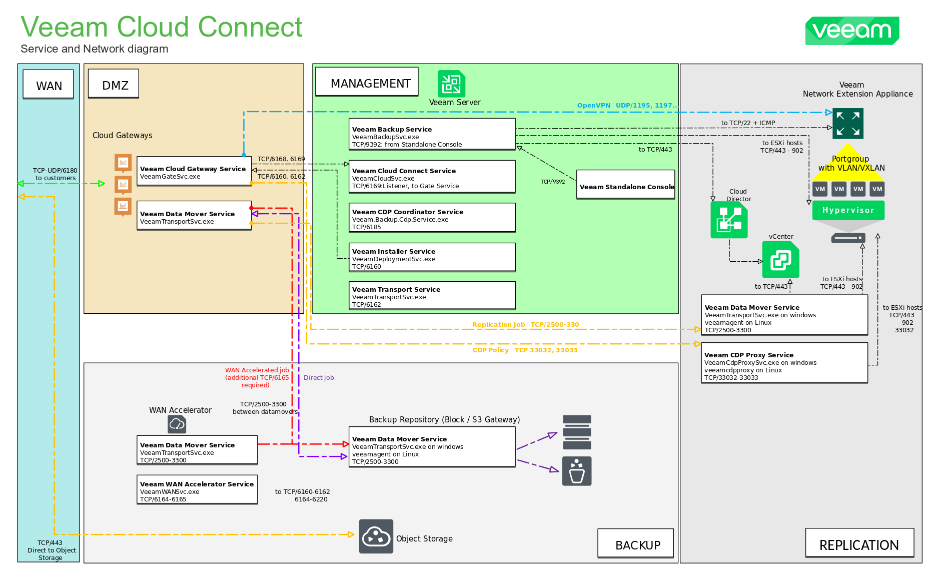

Connectivity Reference Diagram
More information can be found in Reference Architecture, Cloud Gateways Settings, and Used Ports.
Troubleshooting involves a connectivity check between different components:
  • Tenant and Veeam Cloud Connect Gateway.
  • Cloud Connect Gateway and Cloud Connect Repository.
  • Main Cloud Connect server and Cloud Connect Repository.

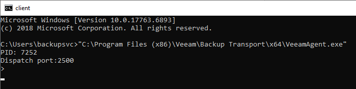

  1. On the Cloud Repository server, manually start the Veeam Agent by running the following executable:
    • Windows Repository:
      C:\Program Files (x86)\Veeam\Backup Transport\x64\VeeamAgent.exe
Windows agent process demo

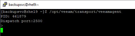

  • Linux Repository:
    /opt/veeam/transport/veeamagent
Linux agent demo

  1. After running the VeeamAgent.exe or veeamagent executable, the process will start and display a Dispatch port. Take note of the Dispatch port; you'll need that for testing in the next step.

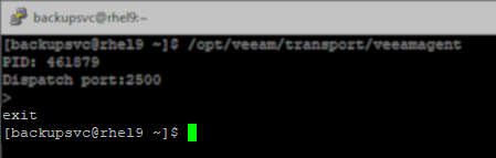

  1. When connection testing to the repository is complete, terminate the agent started in Step 1 by passing the command "exit" to close.
Demonstrating passing exit command to the veeam agent
