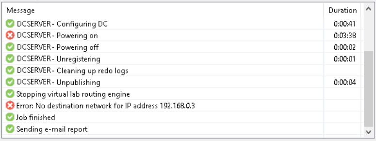

A Surebackup job fails with the error:
Error: No destination network for IP address
A screenshot of the SureBackup status window showing the job failing with the error.

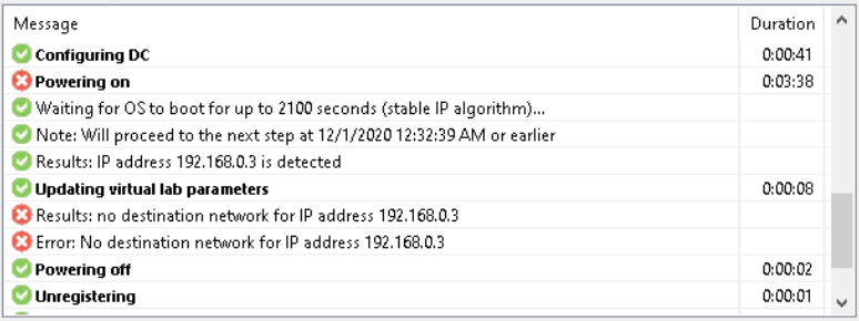

When selecting the individual server from the VM list in the status window, the following error is seen:
Results: no destination network for IP address
Screenshot showing the inidivdual tasks for the selected VM, including the error discussed.

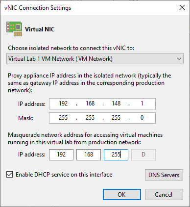

For example, to reproduce the error show at the begining of this KB article, the Virtual NIC used by the Virtual Lab was configured with the following settings:
  • IP address: 192.168.148.1
  • Mask: 255.255.255.0
  • Masquerade IP: 192.168.255.D
This Virtual NIC configuration would match a VM whose static IP falls somewhere in the 192.168.148.0/24 subnet, and uses the gateway IP of 192.168.148.1.
Screenshot of Virtual NIC configuration used to recreate the error: "no destination network for IP address"

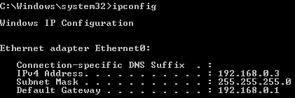

However, upon review of the production machine's network configuration, it is found that it uses a static IP in the 192.168.0.1/24 subnet and has a Default Gateway of 192.168.0.1.
Screenshot showing the output of the command ipconfig run within the product machine that failed to be processed by SureBackup
This misalignment of the network settings used by the machine being tested and the virtual lab vNIC configuration causes the error, "No destination network for IP address 192.168.0.3" to occur.

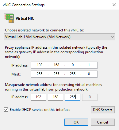

To corect this issue, the Virtual Lab's Virtual NIC must be reconfigured to use the correct IP address matching the Gateway IP the machine being tested is expecting and the same Subnet Mask. The masquerade IP does not need to changed, as it simply needs to be a subnet that is not presently used by any other subnet in the environment.
Therefore, the correct settings would be:
  • IP address: 192.168.0.1
Screenshot showing the corrected virtual NIC settings discussed above.
