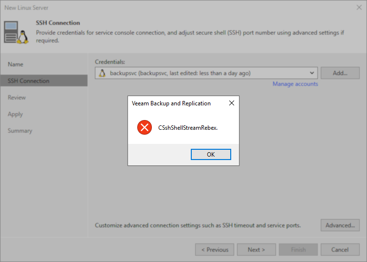

The initial error one will experience when attempting this without following the procedures in the article is:
CSshShellStreamRebex

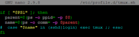

An entry either directly within /etc/bashrc or a second script called by bashrc will control the automatic launching of a tmux session at user login. For example, in RHEL 8.9, the /etc/bashrc does not directly contain the 'exec tmux' entry; instead, tmux.sh is called using an entry in bashrc that calls for all scripts within /etc/profile.d/*.sh to be executed at login.
Once you identify how tmux is being executed at login, there are two options:

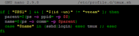

- Option 1: Comment out the entire line containing 'exec tmux' to disable tmux at login system-wide.
(This change can be reverted after the machine has been successfully added to Veeam Backup & Replication.
- Option 2: Modify the if statement to add a qualifier that if the user account matches the specified one, tmux should not be started when that user logs in.
&& [ "$(id -un)" != "veeam" ]

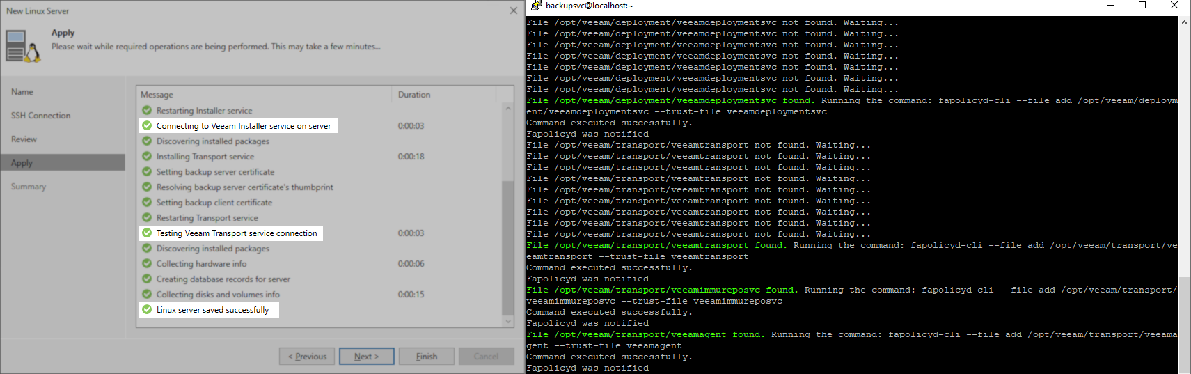

- Before you begin adding the Linux server to Veeam Backup & Replication, run the script. The script will wait for the files to be uploaded to the Linux server, and as it detects them, it will add them to the trusted list within the fapolicy framework.
sudo /opt/veeam/vbr_fapolicyd_updater.sh

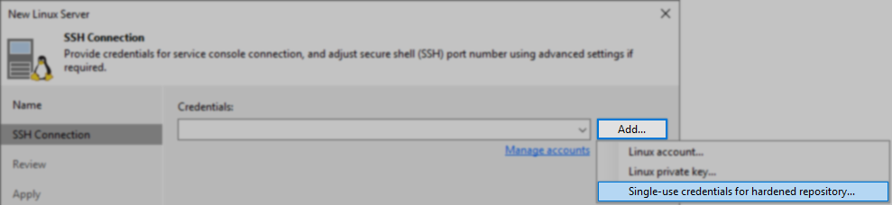

Remember: If this Linux server will be used as a Hardened Linux Repository, you must add the credentials using the "Single-use credentials for hardened repository" option.

As long as the vbr_fapolicyd_updater.sh script is running on that Linux server, the script will find the service files as they are uploaded and add them to the fapolicy trusted list before Veeam Backup & Replication attempts to start the services and communicate with them.
- Click [Finish] to complete adding the Linux Server.
