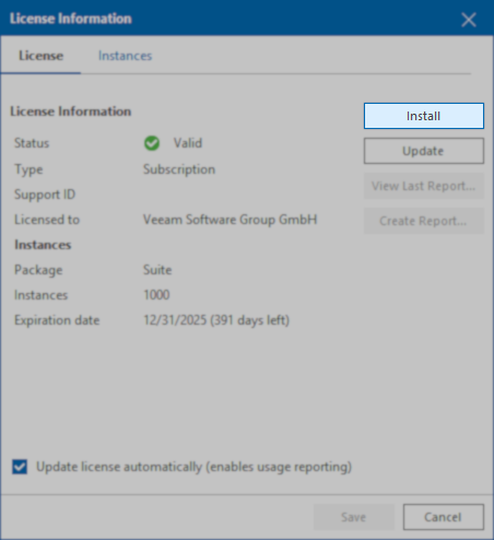

  1. In the dialog window that appears, click Install License.
  2. Using the file selector window that appears, navigate to and select the license file.

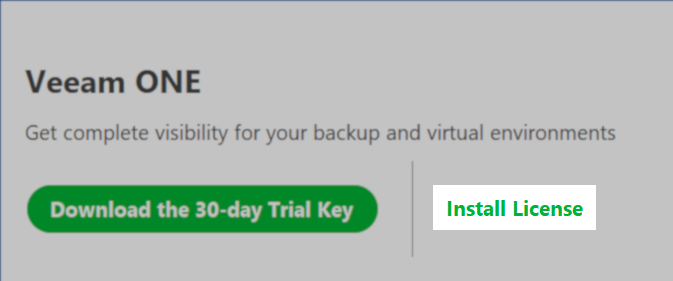

Install New License

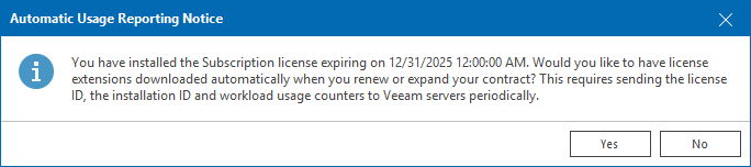

  1. After supplying a license, you may be prompted to confirm whether the software should automatically check for license updates.
auto update

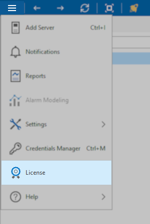

  1. Open Veeam ONE Client.
  2. Click the Main Menu () in the top-left corner.
  3. Click License.

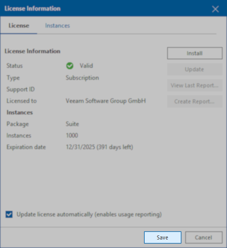

  1. In the License Information window, click the Install button.
Install License
  1. Using the file selector window that appears, navigate to and select the license file you would like Veeam ONE to use.
  2. After you have selected the new license file, click Save.
Save new license

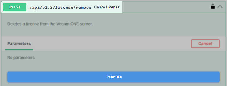

  1. On the Veeam ONE server, open a web browser, and go to https://localhost:1239/swagger/index.html
  2. Authorize by following Step 1 and Step 2 on this page: Veeam ONE REST API Reference - Getting Authorization Tokens
    Note: Read step 2 of the Getting Authorization Token guide very carefully.

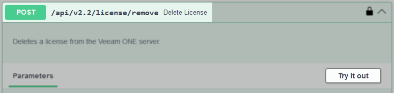

  3. Once Authorized, expand the Licensing section and expand the entry named: POST ​/api​/v2.2​/license​/remove Delete License
  4. Click the "Try it out" button.
API documentation interface showing a POST request to /api/v2.3/license/remove for deleting a license from the Veeam ONE server, with a "Try it out" button.
  1. Then, click the "Execute" button.
API documentation interface for POST /api/v2.3/license/remove to delete a Veeam ONE server license, showing the "Execute" button.

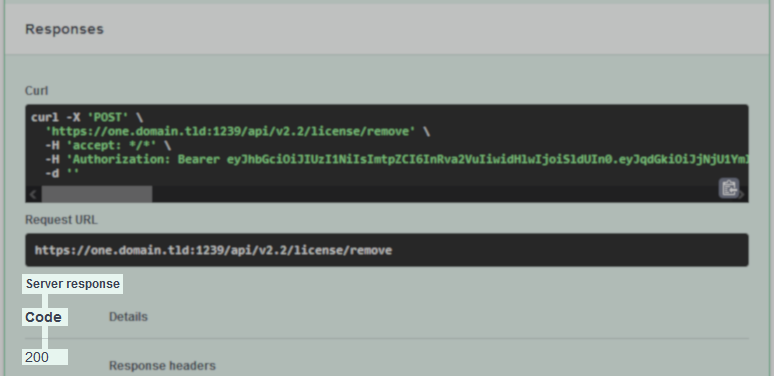

After clicking Execute, the page will update to display a "Server response."
If it returns Code 200, the license was removed successfully.
Code 200
If you received the server response 401 Unauthorized, the authentication and authorization process was not completed correctly. Click Authorize at the top of the Swagger UI page, log out, and try again (remember to add the word 'Bearer ' before the key).
