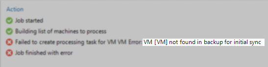

A replication job with seeding enabled fails with any of the following errors:
Failed to create processing task for VM <VM> Error: VM [VM] not found in backup for initial sync
Cannot find VM in the backup file specified for seeding
Error: Specified seed repository does not contain backup of the required VM.

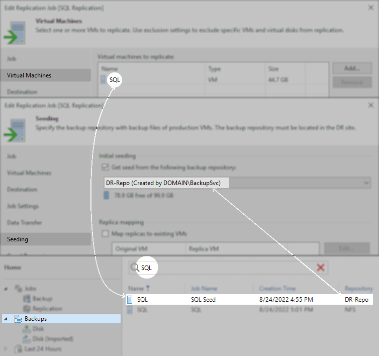

- Review the "Creating Replica Seeds" procedure to ensure all the initial seed creation and placement steps have been followed correctly.
- Rescan the Repository where the replica seeds are stored.
The only way restore points can be added to the database and associated with a repository is for them to be detected during a repository rescan. - Edit the Replication Job and make sure the Repository where the replica seeds are stored is selected for seeding.
- Review the list of restore points under Backups > Disk (Imported) to determine if a replica seed (restore point) for the VM failing to seed is listed with the repository name listed in the repository column.
Next steps based on what you observe:
- If no replica seed is available for that VM associated with Repository being used for seeding, review the underlying storage and ensure that the replica seeds are present on disk.
- If you observe that a replica seed for the VM is present under Backups > Disk (Imported), but the repository column is empty, this indicates that the replica seeds were incorrectly imported using the Import Backup function. To rectify this, use the Remove from configuration function to remove those backups from the database and rescan the repository where the replica seeds are located.
- If a replica seed (restore point) for the VM is present and the correct repository is listed in the Repository column, ensure that the VM is added to the replication job via the same vCenter/Cluster/Host as it was added to the seed-generating backup job.
