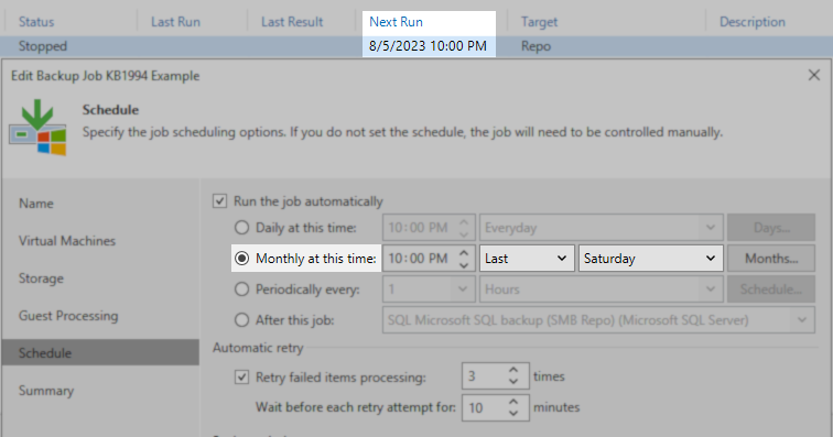

The 'Next Run' date shown for a job does not match the settings selected in the Schedule tab of the job.
For example, a job configured to run Monthly on the last Saturday displays a 'Next Run' date of the upcoming Saturday, which is not the last Saturday of the month.

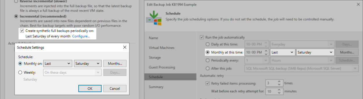

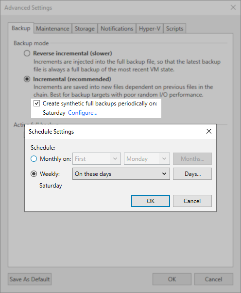

For the example shown in the Challenge section, the following settings are selected within the Storage > Advanced Settings:
The option for Synthetic fulls was enabled and set to occur weekly on Saturdays.
