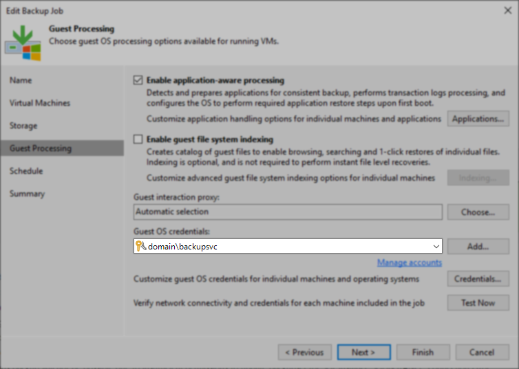

Confirm that the account used by Veeam has required permissions
  • The account used by Veeam to perform truncation must have the required SQL permissions as outlined here.
  • For Virtual Machines (vSphere/Hyper-v), the account is specified on the Guest Processing tab of the Backup Job.
  • For machines backed up using Veeam Agent for Microsoft Windows, the account used for SQL Truncation is the account used to add the machine to the Protection Group.
  • If SQL Truncation cannot be performed with the specified account, the software will failover and attempt to use the NT AUTHORITY\SYSTEM account.
Expand to view example of how to confirm permissions
  1. Identify the account the Backup job is trying to use:
Screenshot showing account in use for Guest Processing

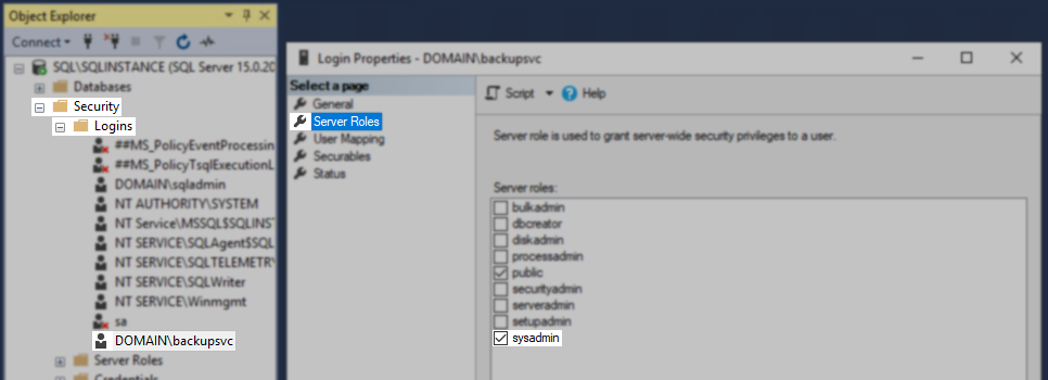

  1. Connect to the SQL Instance on the machine that is failing to truncate and make sure the sysadmin role is assigned to the account used by Veeam.
Screenshot showing sysadmin role assigned

Description = Login failed for user 'DOMAIN\user'.
The user listed in the error cannot connect to the SQL Instance, as it does not have the required SQL permissions.
This specific error means that the account in the error isn't listed in the "Logins" section of the SQL Instance, and therefore has no right to login to the SQL Instance. To resolve this, create a login for the account within the SQL Instance on the machine that is failing to truncate, and assign it the sysadmin role.
Note: You will need to launch SQL Management Studio using an account other than the one in the error, as that account will not have permission to connect to the SQL Instance.
Description = The server principal "DOMAIN\user" is not able to access the database "DBName" under the current security context.
The user listed in the error is able to log in to the SQL Instance but lacks the required SQL permissions to interact with the databases.
To resolve this, connect to the SQL Instance of the machine that is failing to truncate, and edit the login entry ( Security > Logins ), and assign the sysadmin role.
Note: You will need to launch SQL Management Studio using an account other than the one in the error, as that account will not have sufficient permissions to assign itself the sysadmin role.
