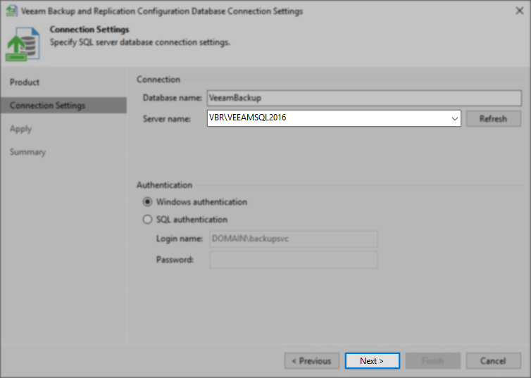

  1. Open the Configuration Database Connection Settings program, which should appear in the start menu of the Veeam Backup & Replication server.
  2. Within this program, select Veeam Backup and Replication, then click Next.
    (If Enterprise Manager is not installed, you will not be prompted to select a product.)
  3. Adjust the value specified in the Server name field to match the correct hostname.
    Note: Use either localhost or the new hostname.
  4. Click Next, and Veeam will connect to the database. Wait for this process to complete.
Screenshot of DB Config Tool
  1. Click Next, and the Veeam service will be started.
    Note: If prompted to restart other services, click Yes.
  2. When this has been completed, click Finish, then try accessing the Veeam Backup & Replication Console.
