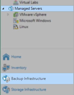

Gather Old Machine Name From UI
Prior to running the commands below you need to identify the Name\FQDN\IP Veeam is using to communicate with the Managed Server currently. To do this, edit the entry for a Managed Server under Backup Infrastructure and note the “Name:”.

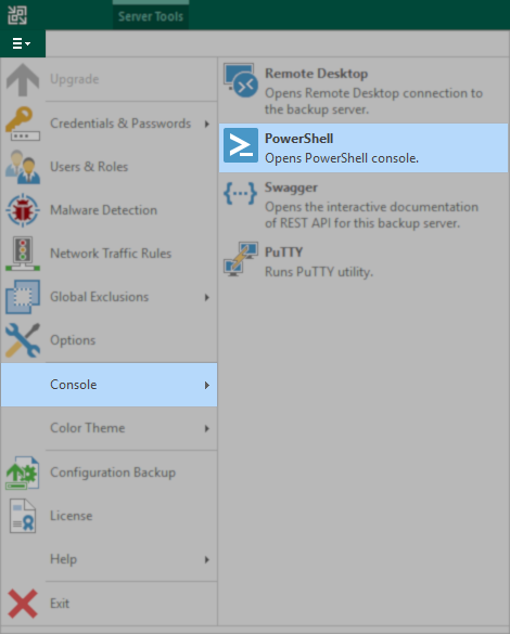

- Launch PowerShell from inside the Veeam Backup & Replication console. You can find the "PowerShell" button under the Main Menu's "Console" section.
- The Veeam Backup & Replication PowerShell Toolkit will load.

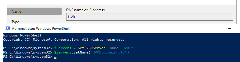

- Run the following command:
$Servers = Get-VBRServer -name "old-name"
Do not remove the quotes on either side.
- Run the following command next to change the name:
$Servers.SetName("new-name")
