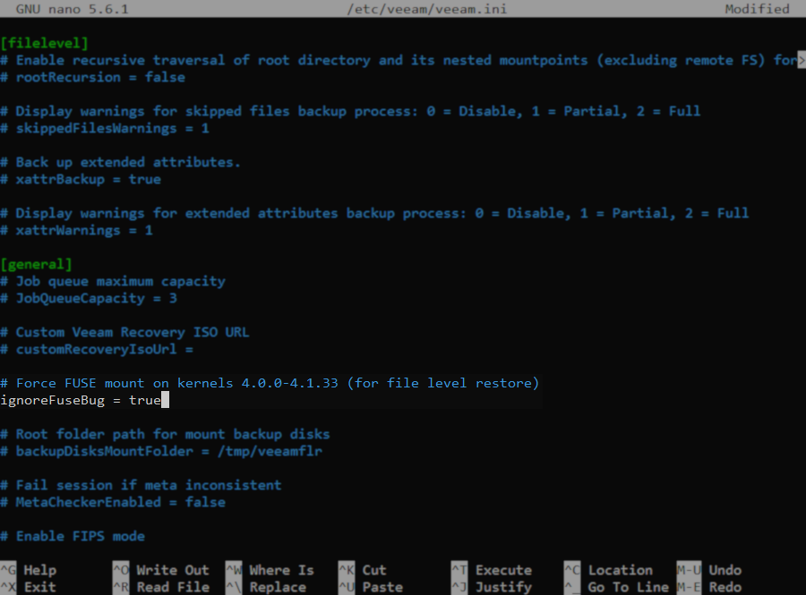

However, in some distributions, the fix was backported to those older kernels. In that case, it is possible to force Veeam Agent for Linux to attempt the mount despite the detected kernel version:
Note: This will only work if the installed kernel contains the backported fix for this bug.
- Open the Veeam Agent for Linux global configuration file — /etc/veeam/veeam.ini
- Uncomment the
ignoreFuseBugline, change the value fromfalsetotrue, and save the file.
- Restart the
veeamserviceservice to apply the changes. - Retry the restore.
