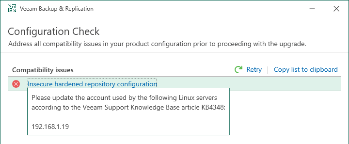

When attempting to upgrade to Veeam Backup & Replication 12, the upgrade Configuration Check displays a Compatibility issue: "Insecure hardened repository configuration." The mouse-over tooltip for this issue states:
Please update the account used by the following Linux servers according to the Veeam Support Knowledge Base article KB4348: <Linux Server Name>

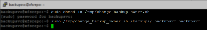

After changing the account used with the Linux server, the Veeam Data Movers will lose access to previously written restore points. Use the script below to reassign ownership of the backup files to the new non-root account to ensure continued access to the existing restore points.
Reassigning Ownership of Restore Points
When changing the account used by Veeam Backup & Replication to connect to the Linux server, all files and folders within the repository path must have their ownership changed using the chown command. However, the files marked as immutable must first have their immutability status removed using chattr -i. Once the ownership has been changed, the immutability flag must be reapplied to those files where it was removed using chattr +i. It is critical that only the files that were immutable before the ownership change have the immutability flag reapplied.
Below is an example bash script that performs these steps and tracks which files were immutable before the ownership change. This script is an example and may not function with some distributions of Linux. It should be run as root (or using sudo) to reassign ownership of the backup files in the immutable repository path.
Warning: Saving the shell script with a Windows text editor may add hidden characters that prevent it from running on Linux. To avoid issues, please paste the script directly into the Linux system via SSH.
Script Syntax: ./change_backup_owner.sh <repository_path> <username> <groupname>
