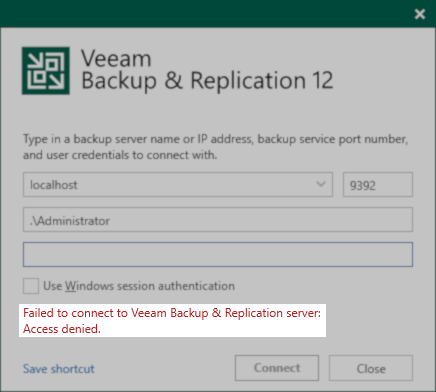

After performing Configuration Restore using the Migration mode from a Configuration Backup created by a Veeam Backup & Replication server that had MFA enabled, login attempts using local accounts cause the Veeam Backup & Replication Console to display the error:
Failed to connect to Veeam Backup & Replication server:
Access denied.
Error
While this issue will always occur when using the Migrate mode to move between machines, it is more noticeable when migrating from a domain-joined machine to a non-domain-joined machine due to only being able to use local accounts to sign in via the Veeam Backup & Replication Console.
