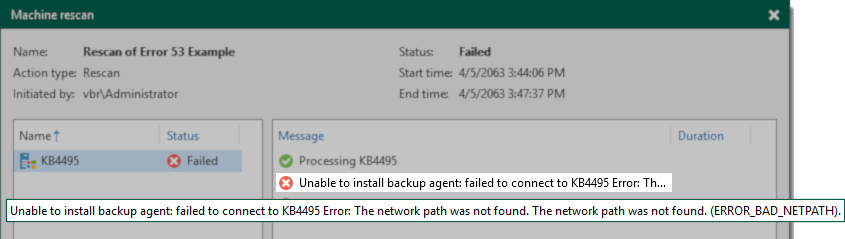

During the rescan of a Protection Group or individual Windows machine, the rescan fails with the error:
Unable to install backup agent: failed to connect to <machine_name> Error: The network path was not found. The network path was not found. (ERROR_BAD_NETPATH).
Example Error
Please note that the KB number appears in the error because it was the name assigned to the machine when these screenshots were taken.
Example Log File Content

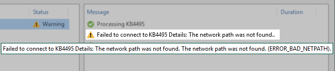

A warning similar to the one shown above will occur if the credentials provided are incorrectly formatted. However, it will state "Failed to connect" and be a warning. Credentials must be formatted with a username specified in the down-level logon name format (e.g., either domain\username or hostname\Administrator) and not with a dot slash (i.e., .\Administrator).
Note: Use of a local account other than Administrator will likely fail; see KB4185.
Failed to connect to <name> Details: The network path was not found. The network path was not found. (ERROR_BAD_NETPATH).
Warning
