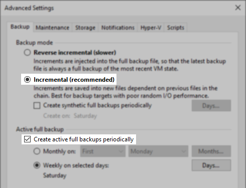

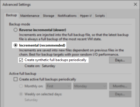

The  Forward Incremental* Backup mode's method of retention enforcement often leads to misunderstandings about "Too many restore points." Forward Incremental Backup mode is enabled when a job when Incremental is selected and Synthetic Full or Active Full, or both, are enabled. Please review the information below to understand more about Forward Incremental retention and how its behavior may be misinterpreted.
*When the Incremental backup mode is selected, and neither synthetic full backups nor active full backups are enabled, the job will operate in Forever Forward Incremental mode.
Incremental with Synthetic Fulls
Forward Incremental with Synthetic Fulls enabled
Forward Incremental with Active Fulls enabled

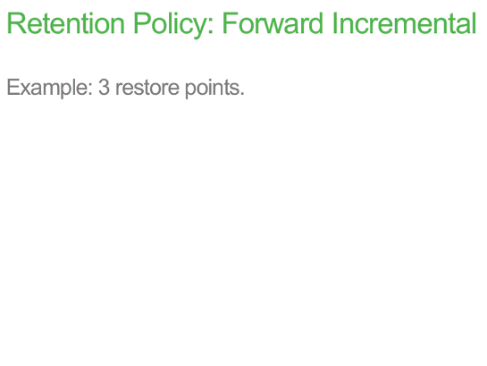

When a backup job uses Forward Incremental mode, the job will maintain more restore points on disk than specified to meet retention. The retention setting specifies a minimum number of restore points or days that should be available to be restored, not the maximum number of restore points.
This is explained further in the user guide: Forward Incremental Backup Retention Policy.
retention demo
Within the above animation, the lettered squares represent blocks on a disk.
Each Full (VBK) that is created starts a new Backup Chain, and until all restore points of the oldest backup chain are outside of retention, no portion of that chain can be deleted by retention.
