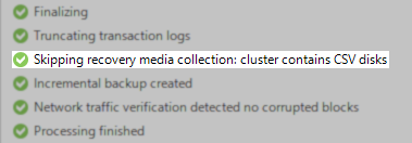

The Windows Agent Backup job for a failover cluster node with a cluster shared volume displays the following notice:
Skipping recovery media collection: cluster contains CSV disks
RMCSkip

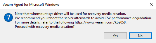

Attempting to create recovery media manually using the Recovery Media Creator on the failover cluster node displays the following notice:
Note that wimmount.sys driver will be used for recovery media creation.
We recommend you reboot the server afterward to avoid CSV performance degradation.
For more details, refer to the following https://www.veeam.com/kb2058.
Proceed with recovery media creation?

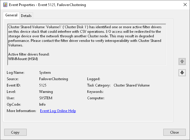

If the recovery media creation/collection process is forced to occur, the usage of the WIMMount driver causes CSVs owned by that failover cluster node to enter "Redirected Access" mode. When that happens, the System event log will list the following event:
Event 5125, FailoverClustering
Cluster Shared Volume 'Volume1' ('Cluster Disk 1') has identified one or more active filter drivers
on this device stack that could interfere with CSV operations. I/O access will be redirected to the
storage device over the network through another Cluster node. This may result in degraded
performance. Please contact the filter driver vendor to verify interoperability with Cluster Shared
Volumes.
Active filter drivers found:
WIMMount (HSM)
Event5125
Redirected Access
In some environments, the CSV(s) may not immediately enter Redirect Access mode. Instead, the CSV(s) will enter Redirect Access mode when moved to the node where the recovery media collection occurred.

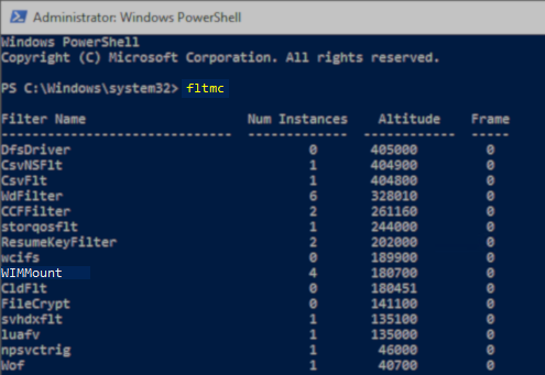

As indicated in Event 5125, the CSV enters Redirected Acces mode because the WIMMount filter driver is active. This can be confirmed using the fltmc command.
fltmc results

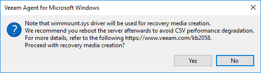

The Create Recovery Media wizard will provide the following warning:
Recovery Media Warning
Click Yes, and the recovery media creation process will commence.
After the recovery media is created, a reboot will need to occur to prevent CSVs that become owned by that node from entering Redirected Access mode.
