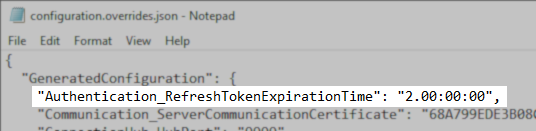

- If the SessionExpirationTime was set to two days or more (2.00:00:00 or more), open the following configuration file:
C:\ProgramData\Veeam\Veeam Availability Console\Configuration\Service\configuration.overrides.json
- Create a new parameter:
"Authentication_RefreshTokenExpirationTime": "2.00:00:00",
- Set the Authentication_RefreshTokenExpirationTime value higher than the SessionExpirationTime value.
The default Authentication_RefreshTokenExpirationTime is "2.00:00:00", which represents two days.
For example, if you set SessionExpirationTime to "2.00:00:00" set the refreshTokenExpirationTime value to be "3.00:00:00" - Save the modified configuration.overrides.json file.
