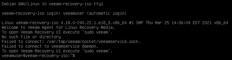

Challenge
When booting from a recovery media image patched on specific Linux kernels, veeamservice does not start correctly. As a result, the recovery UI is inaccessible. The following output is displayed instead:
Linux veeam-recovery-iso 4.18.0-240.22.1.e18_3.x86_64 #1 SMP Thu Mar 25 14:36:04 EDT 2021 X86_64 Welcome to Veeam Agent for Linux Recovery Media. To open Veeam Recovery UI execute 'sudo veeam'. No such file or directory Failed to connect: /var/tmp/veeam/socket/veeamservice.sock. Failed to connect to veeamservice daemon. To open Veeam Recovery UI execute 'sudo veeam'.

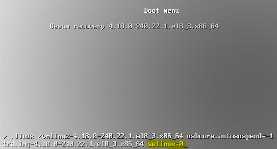

Workaround
To access the recovery UI, reboot and press TAB in the Boot menu of the Recovery Media. Add " selinux=0" to the end of the kernel command line and press Enter to finish the boot process.
