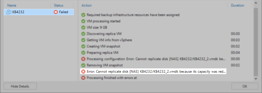

After a VM's disks have been resized to be smaller, the Replication job within Veeam Backup & Replication fails with the following error:
Processing <vmname> Error: Cannot replicate disk [Datastore] vmfolder/vmname.vmdk because its capacity was reduced
Cannot replicate disk because its capacity was reduced

  1. Note the name of the VM and the disk mentioned in the error.
Note the VM and the disk path shown in the error

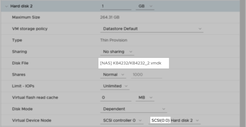

  1. Edit the VM being replicated, and identify which SCSI node is assigned to the disk in the error. Cancel out of editing the VM, making no changes.
Identify SCSI node on production machine

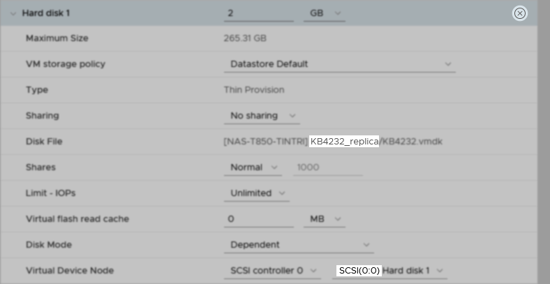

  1. Edit the Replica
  2. Find the disk attached to the SCSI node identified in Step 2.
  3. Remove it using the ( X ) for the Hard disk entry.
  4. Check the box for "Delete files from datastore"
  5. Click OK to complete the process.
Identify the disk with the same SCSI node and remove it from the replica
Delete Disk From Datastore
