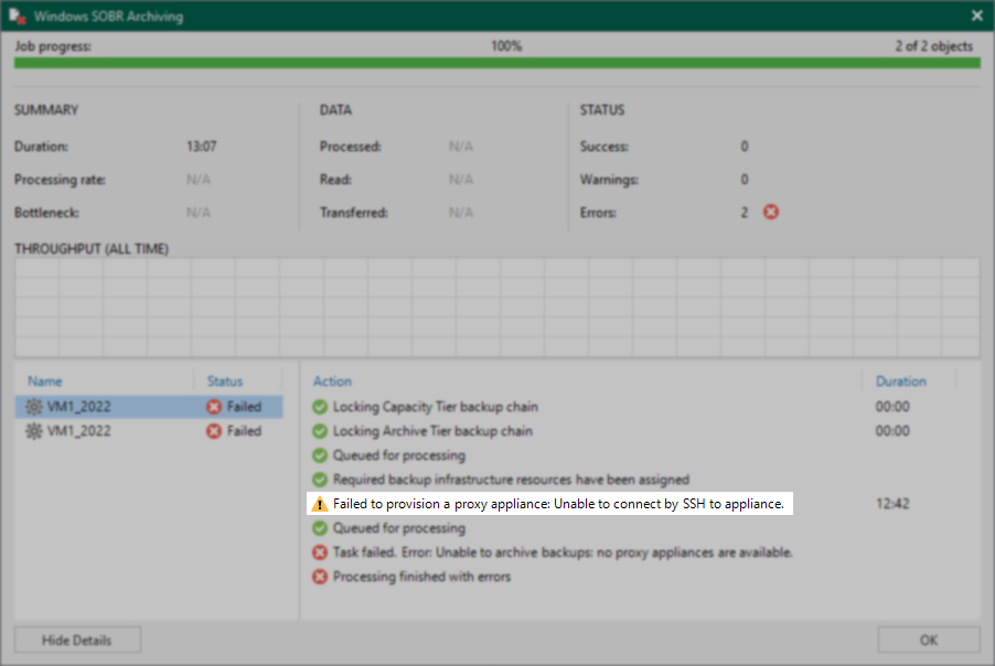

An Archiving Job for a Scale-Out Backup Repository fails with the error:
Failed to provision a proxy appliance: Unable to connect by SSH to Appliance.
Log Example
[dd.mm.yyyy hh:mm:ss] <tid> Warning Failed to provision a proxy appliance: Unable to connect by SSH to appliance.
[dd.mm.yyyy hh:mm:ss] <tid> Error Failed to login to host: '<appliance_ip>', port: 22, elevation to root: 'yes', autoSudo: no, use su if sudo fails: no, host name: , IPs: [<appliance_ip>], AuthenticationData: [UserName: ubuntu, AuthTypes: [KeyboardInteractive, Password]]. Unable to establish connection to host <appliance_ip> on any IP address. (System.Exception)

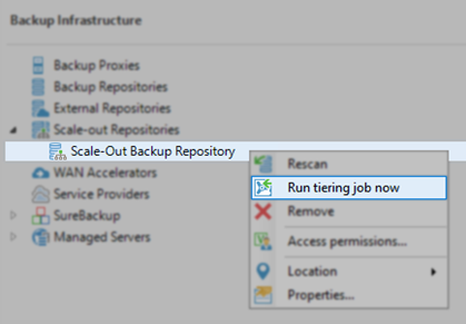

  2. Force the Tiering Job to start.
    This is done because the Archive Tiering Appliance is non-persistent and only exists when an Archiving Task occurs.
    1. Hold the Ctrl key on the keyboard and right-click on the Scale-Out Backup Repository.
    2. In the context menu, select "Run tiering job now"
Run tiering job

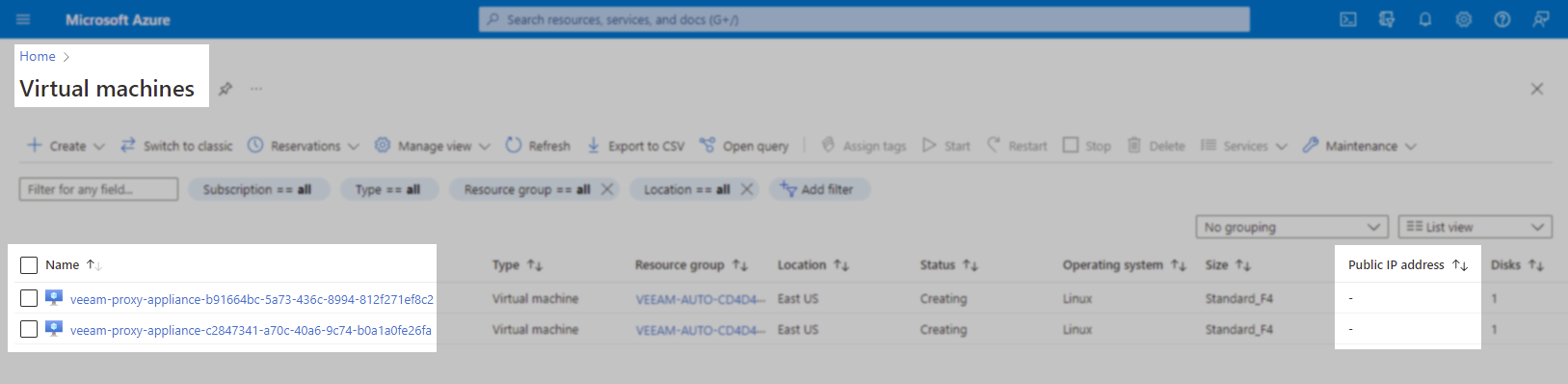

  1. Identify the IP address of the Archiving Job's Proxy Appliance(s).
AWS Instance List
For AWS EC2, when the Archive Tier task starts, you will find the IP of the Proxy Appliance here.
Azure Virtual Machines list
For Azure, when the Archive Tier task starts, you will find the IP of the Proxy Appliance here.
