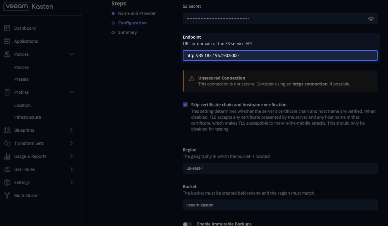

- Update the Endpoint details in the Location Profile for the S3-compatible store.

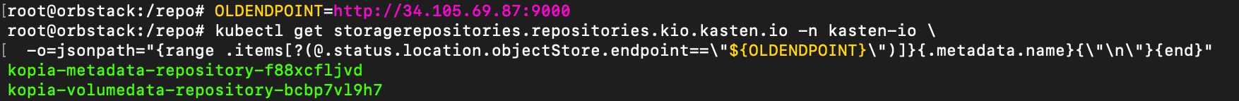

- Use the following command to identify the storage repositories that point to the old location endpoint:
Note: Update the OLDENDPOINT variable with the old endpoint details. The example variable value shown is relevant only to the use case example being presented.
Output is highlighted in Green.
