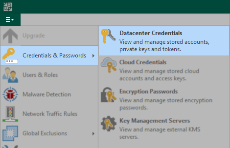

How to Open the Credentials Manager
From the Veeam Backup & Replication Console's Main Menu (≡) under Credentials & Passwords, click Datacenter Credentials.
